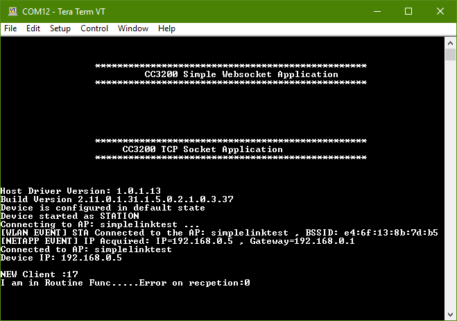

    I have got the log file of the project. Also,  some code snippet is here.
    void ServerRoutine(void *NewSock)
       char buff[1024];
        int     iStatus;
        int NewSoc=*((int *)NewSock);
        Report("I am in Routine Func");
        again: iStatus = sl_Recv(NewSoc, buff, 1024, 0);
            if(iStatus==SL_EAGAIN)
              goto again;
            else if( iStatus <= 0 )
              // error
              sl_Close(NewSoc);
              Report("Error on recpetion:%d\n\r",iStatus);
              //ASSERT_ON_ERROR(RECV_ERROR);
            else
            {       buff[iStatus]='\0';
                    Report("Data recieved:%s\n\r",buff);
                    Report("Recieved packet successfully\n\r");

    Is your code based off of the tcp_socket example from the SDK? Did you only copy the functions above into your own project, or are you modifying the tcp_socket example project directly?
    Does the sl_Accept() always result in the -100 abort, with even the first connection to the server causing the abort? Or is it returning -100 before any client even connects?
    Also, can you re-upload the NWP logs? It appears to be inaccessible.
    Michael
    I'm using WLAN Station example from SDK (as It has FreeRTOS configured) and trying to run a Server on port 5001 using a Socket.
    The sl_Accept() always results in -100 abort and can't able to connect with any client.

    I got the log file please let me know the problem. The code snippet is given above and log file is here:
    Looking at the logs, it seems like you do not have an up to date servicepack flashed on the device. Please download the latest servicepack here: https://www.ti.com/tool/download/CC3200SDK
    then, follow the steps here under "Service Pack Programming" to flash the servicepack. http://processors.wiki.ti.com/index.php/CC3100_%26_CC3200_UniFlash_Quick_Start_Guide
    Try running your program again after you have flashed the latest servicepack.

  • Hi Shivam,
    A few things I note:
    1. What are your task priorities? If the tcp socket task spawned after sl_Accept() is lower priority, then the passed-in socket ID will be set to -1 before the value can be copied in the spawned thread. This will cause an error in the NWP, as you will be trying to read from an invalid socket ID.
    2. You probably don't want to be using MAP_UtilsDelay() in your socket handler function, as that will prevent the scheduler from marking that thread as blocked and allow preempted threads to run. Instead, you should use osi_sleep().
    I copied your code and the general concept works correctly. I have made a few modifications along the lines of the notes above, and it runs as expected. I can connect two TCP clients and transfer data in parallel on my setup with the attached code. Please try running my code and see if that works with your setup.

  • Hi Michael,
    After applying the changes in the code given by you ( mainly adding ASSERT_ON_ERROR statements which weren't there earlier). I found that the socket isn't even created. The function sl_Socket() is returning SL_API_ABORTED (-100). But still, I couldn't figure out how to get rid of it.
    Shivam.

  • Hi Michael,
    I uploaded the code provided by you. The device connects to SSID="simplelinktest" successfully and I was able to connect my first tcp client with it. But the second client fails to connect (it waits till the first on exits). I have got the terminal window, have a look.
  • Hi Shivam,
    There is a bug with the usage of osi_TaskDelete() in ServerRoutine(). After fixing that by ensuring the serverThread deletes its own thread handle (and not NULL), everything works as expected and I can connect multiple TCP clients without issues.

  • Hi Michael,
    I added the files and code and uploaded it. But still, there is some problem. The program stuck at sl_Socket() every time. As socket isn't created, I can't test it further for multiple clients. This problem was also occurring previously (as I told you) but I don't know why. Its been too long but I'm not able to figure out this problem.
  • Hi Shivam,
    When I test the program on my setup, I do not run into any issues with opening the socket, nor with closing the socket and exiting the thread.
    Attached is the full project CCS project directory that I used without issues.
    /cfs-file/__key/communityserver-discussions-components-files/968/2514.tcpserver_5F00_cc3200_5F00_threaded.7z
    Please try flashing my .bin onto your CC3200 launchpad or using the debugger to load the .out and see if you have the same issues. The SSID and key needed for your AP is the same as last time.
    Michael
  • Hi Michael,
    This time it worked! Yes, finally it worked. I loaded the .bin file and tested it with 3 clients (Pc, two phones). I can connect all at the same time and send data.
    Thanks a lot for helping me.

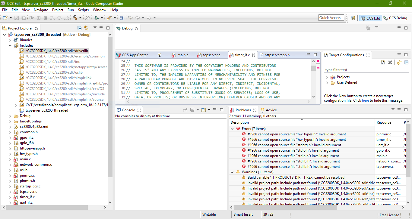

  • Hi Michael,
    I was trying to understand your code and that's why I imported the project into CCS v6 (Earlier I was using IAR). But when build the project I see some errors like:
    After looking the errors I checked include paths which were like this :
    Then I changed all the path to :
    $C:/TI/CC3200SDK_1.3.0/cc3200-sdk/simplelink/   (like this).
    But still, I'm getting the same errors.
    Can you help me?
    Shivam
  • Hi Shivam,
    I am using CCS 9.1 for my CC3200 SDK projects, including the one I provided in my previous post. There could definitely be compatibility issues when taking a project generated for CCS 9 and attempting to build it in CCS 6. I suggest that you install CCS 9 and see if you can import my project into a CCS9 workspace and see if that resolves your issues.
    Michael
