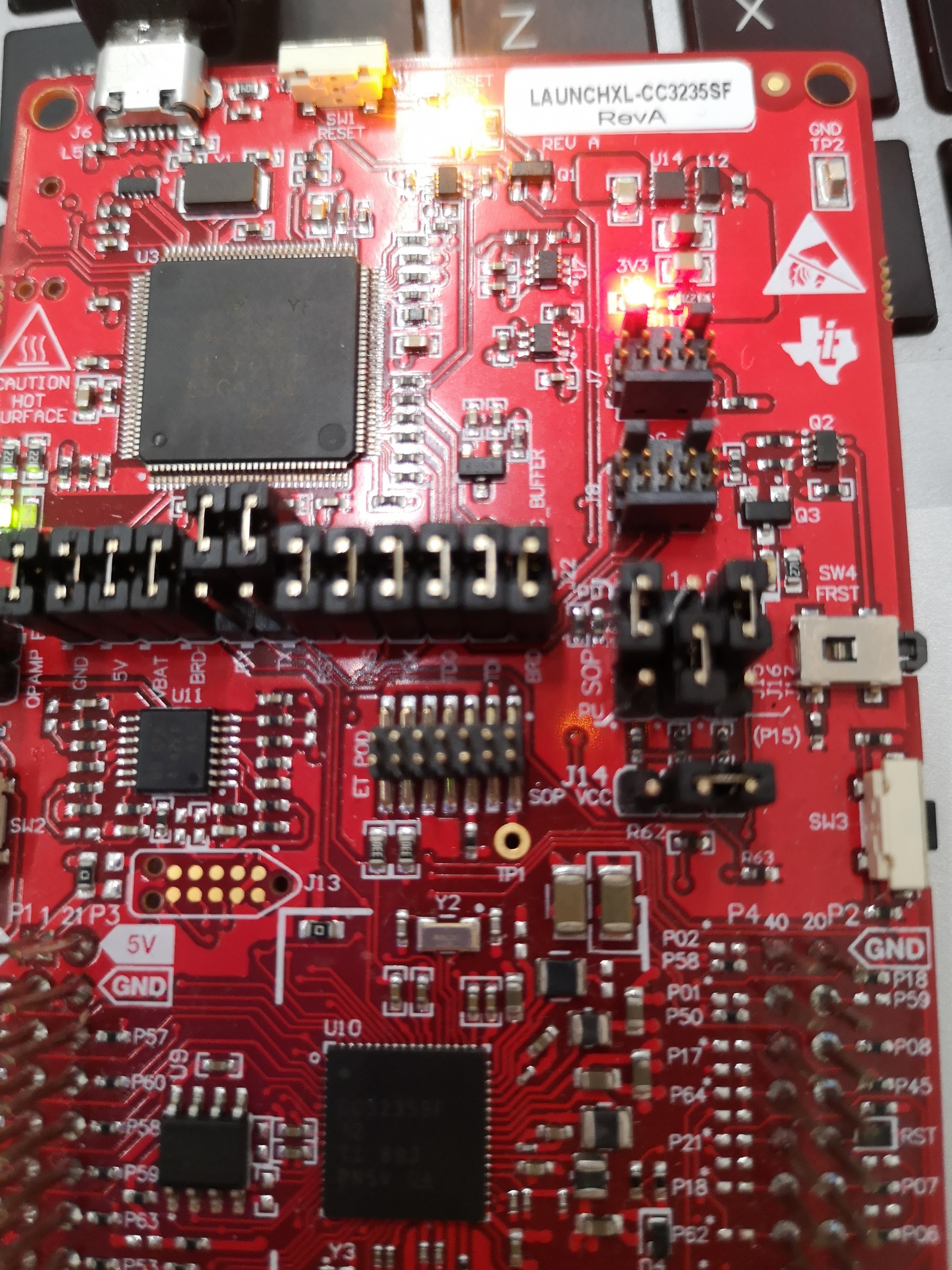

I am using the CC3235SF launchpad and I would like to flash the program to the internal flash memory in order to have it stored also when the power is off.
I have configured the SOP pins as 010 which is the functional and flash mode. However, when I remove the usb cable and put it back the device resets and the program has to be uploaded again.
Can you give me some advice of how to flash the program correctly?
Thanks in advance!
Artemis

    I will try that and let you know, however, I was wondering if I need to use Uniflash even for a simple program, like blinking an LED on the board?Or is it some simpler way like jumper setting for starting the program each time the power is on without reprogramming it.
    Also, just to be sure is this configuration correct for CC3235SF?
    Thanks a lot,
    Artemis
  • Hi Artemis,
    From development IDE like a CCS you can upload code directly into XIP flash and debug there your code. If you need to code which persist restart you need to use Unfilash (with one exception). Your jumper settings is OK.

  • Hi Artemis,
    If you need to have persistent code after restart, you need to use Uniflash. There is no other option then use Uniflash.
    To be able use Energia generated code at CC32xxSF device you have two options:
    • you can use my bootlaoder stated above
    • use this trick described by Michael
    But my bootlaoder was developed for CC3220SF device, and it may/may not be functional at CC3235SF. This you need to test by yourself. In case of issue you can change code of bootloader. CCS project with bootlaoder is available here.
    Questions related to Energia is better to ask at this forum.
    Jan
  • Hey Jan,
    I tried again using your bootloader and it worked for cc3235SF (at least for a simple example).
    Thanks a lot for the help!
