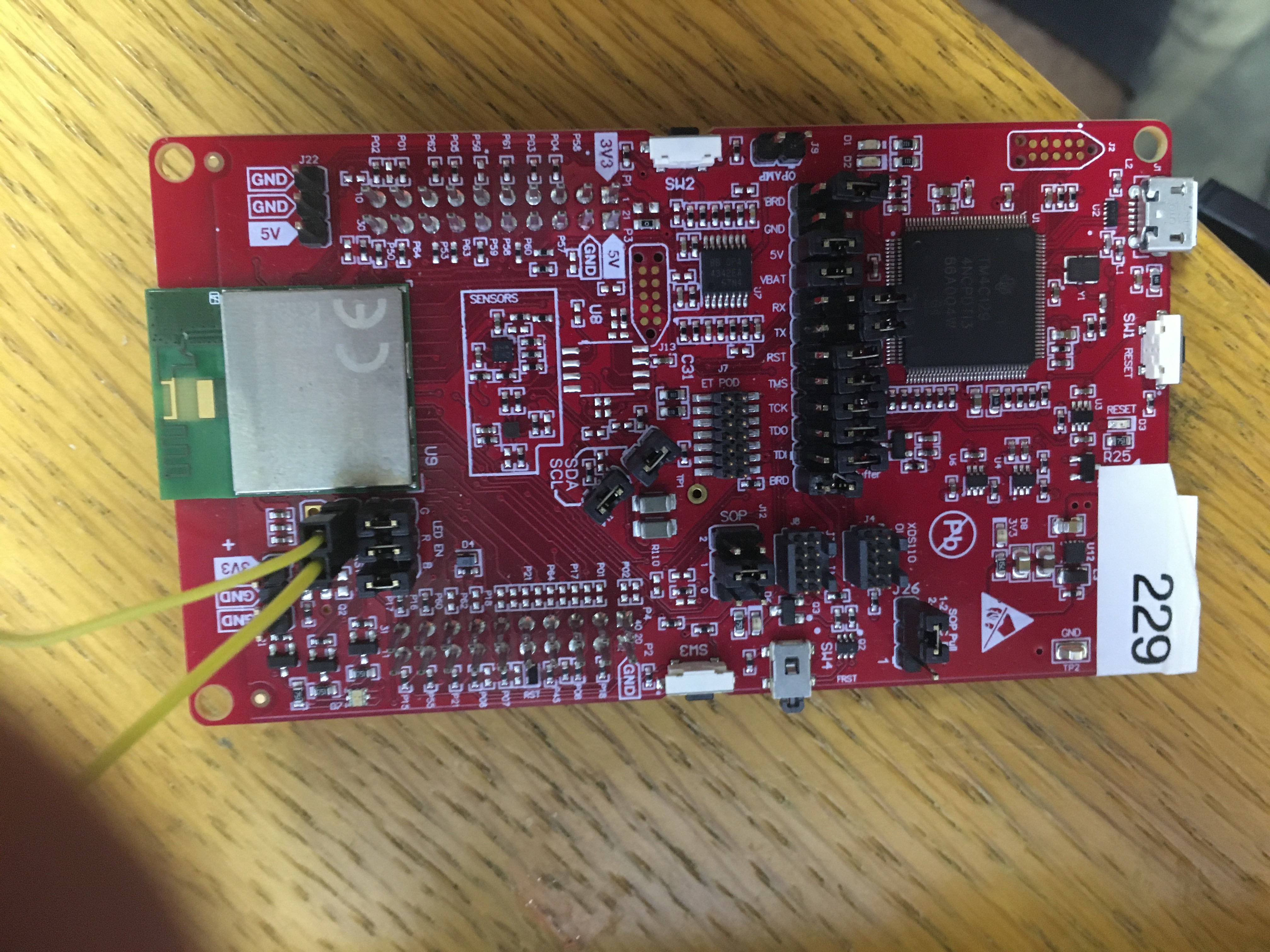

I was looking at support thread: "CC3220MOD: CC3220MOD Schematic and Gerber for review" and "CC3220MODA: CC3220MODA questions" and I have a follow-up question. I can't get my program to execute properly on power up on the CC3220MODASF LaunchPad when I configure it like the circuit in this support thread. I removed the J3, J5 and J6 jumpers (disconnecting the XDS microcontroller from the CC3220MOD). I shorted J10 to connect VBAT_RESET to 3.3V. I removed J16 to remove the shottky diode and another 100k pullup connected to the nReset pin (and all other power to the BRD circuitry). However, when I power up the LaunchPad, my flashed program never starts executing. However, if I hit the reset button (SW1), it always works.
I think I need to add a reset IC like the TPS3839L30DQNR to my CC3220MOD design to get my code to execute on power up correctly. Does that sound right?

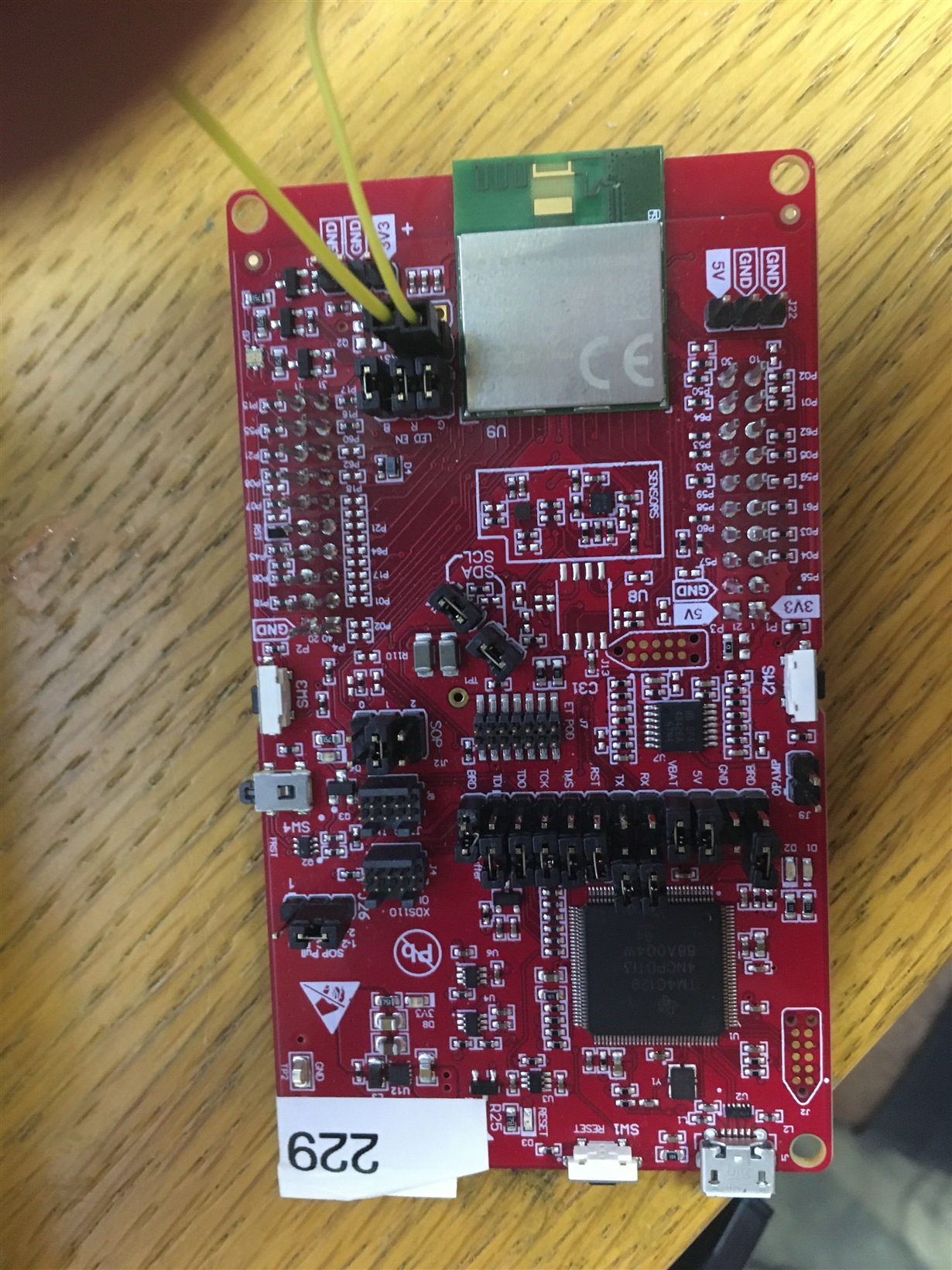

  • Hi Seong – thanks for responding. I don't have my custom board yet. I just moved the jumpers (as described in my post) on the LaunchPad (see attached pic) so that there were no external connections to the nReset pin - like in your schematic on the other post. The datasheet says you should tie the VBAT_RESET to VBAT if you aren't always driving nReset. I thought that implied that it was ok to never drive nReset as long as you connected VBAT_RESET to VBAT.
     I didn’t capture the scope traces but I looked at them and the nReset definitely did not meet the 5ms requirement after VBAT stable nor did the LaunchPad execute the code correctly on power up. That is what prompted my question:
    "I think I need to add a reset IC like the TPS3839L30DQNR to my CC3220MOD design to get my code to execute on power up correctly. Does that sound right?"
  • Ed,
    I just tried testing this on my own LaunchPad with the same jumper configuration and the module is able to run the application image without requiring a reset. There may be an issue with your particular board.
    You can add a reset IC to your custom board if you'd like but is normally not a requirement.
    If you bought your LaunchPad thorugh the TI store, you can reach out to the support for the store and request an exchange. If you ordered it from another vendor, you might be able to do the same with them, but we don't control that.
