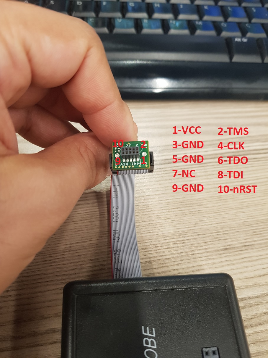

    My problem is a bit different from these issues.I don't connect JTAG cable to my board. I only connect "TMDSEMU110-U" device to PC and press verify button at CCS IDE side. And ı get this error message. Firstly, How should I verify device from CCS IDE side?
    Thanks.

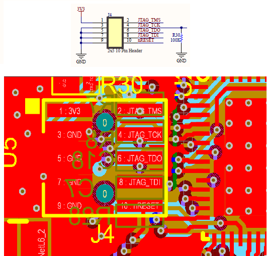

    Could you please check the marked pinout of XDS110 are True or Not? I marked Pin numbers and definitions at below picture. I couldn't verify device with my board. My Board's JTAG Connector pinout (schematic and PCB) are defined at below also. Could you please check the pinouts and inform me? I want to only be sure my connections are True when I plugged XDS110's ARM 10 Cable to my board?
  • Hİ,
    I proceeded at circuit side and I could successfully verified the my circuit over TSDSEMU110U Programming device; But unfortunately I have not programmed device, yet. I got below messages. So could you check device pinout which I asked at my last post at top and confirm pins' connections are True?

  • What device and board are you using? Is it a custom board?
    Yes it is custom board which we designed with CC3220SF Core. I defined its programming connector at top side. My CC3220SF connection schematic is same with CC3220SF LaunchPad reference schematic.

    The error message provided in CCS indicates that you are using SWD mode for the debugger connection.
    What settings do you have for the SOP pins (p21, p34-35)? In order for the device to allow for SWD connections, you will need to have SOP[2:0] be set to 001.
    See table 6.6 of the datasheet for a description of the various SOP modes:
    https://www.ti.com/lit/ds/symlink/cc3220s.pdf
    Also, have you programmed your CC3220SF so that it is in development mode? As part of the bring up process, you will need to program the CC3220SF serial flash, and you will need to set the device into development mode in order to unlock debug access. Some instructions can be found here: https://www.ti.com/lit/swru469
