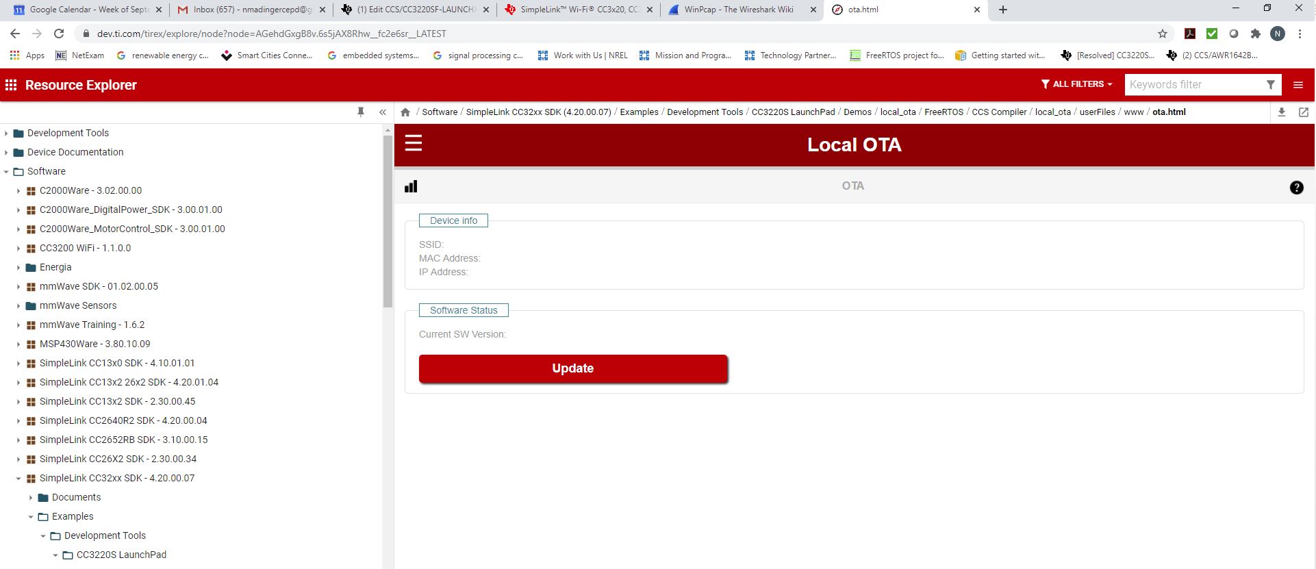

I connected my PC to the same hotspot, and went to the dev.ti.com ota.html link.  I then went to my workspace (local_ota/example_tar), and tried to upload the cc3220sf_local_ota_freertos_ota.tar file.  The website got stuck and nothing happened.

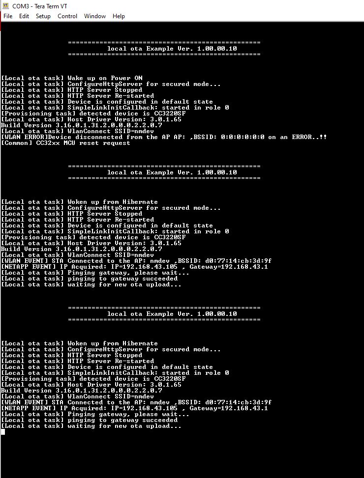

  • Did you get any more terminal logs?

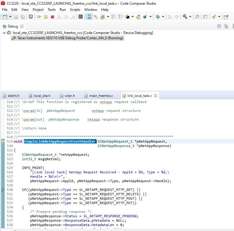

    Is the SimpleLinkNetAppRequestEventHandler() being called? Does the PUT request is being called?
    Can you suspend the execution using the debugger and check that the program still runs as expected?
    I'm not sure what do you mean by "dev.ti.com ota.html link", do you see the ota web page on the browser? do you see the device version information? (this means that the HTTP GET request is working).

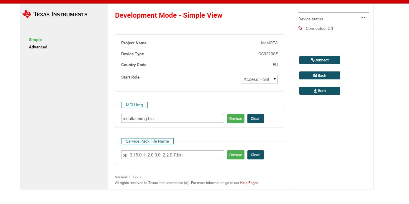

    Thank you for the quick reply!  I realize I didn't provide enough background information, so I will first show what has been programmed to the CC3220 using uniflash.
    The MCU img is the .bin file from the project that was built.  On my PC it is here: \local_ota_CC3220SF_LAUNCHXL_freertos_ccs\MCU+Image
    The Service Pack File is from the SimpleLink SDK.  On my PC it is here: C:\ti\simplelink_cc32xx_sdk_4_20_00_07\tools\cc32xx_tools\servicepack-cc3x20

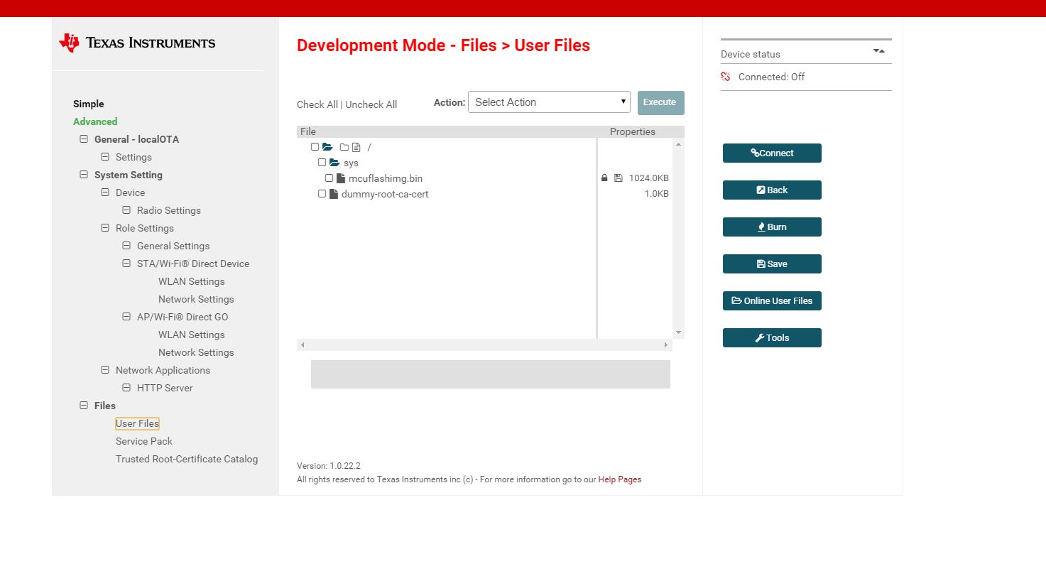

    The user files that I burned into the CC3220 device look like this:
    Am I missing any essential files?  I previous posts I saw that others had included .zip files.  However, I do not know how to include these, if they are needed.
    My serial terminal log looks like this:
    Regarding the SimpleLink Handler call, no, this event handler is not being called.  However, the CC3220 does connect to nmdev and is waiting for OTA:

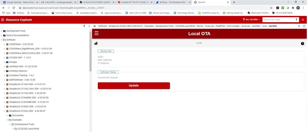

    Regarding the ota.html, I am referencing this website.  Please, keep in mind that both the CC3220 and my PC are connect to my mobile hotspot "nmdev":

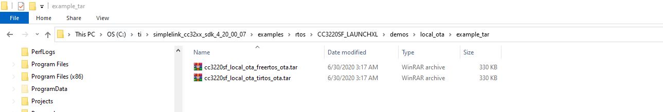

    I have suspended the debugger, and the program does allow the CC3220 to connect, as stated.  However, I cannot load an image via the ota.html.  I go to the directory (C:\ti\simplelink_cc32xx_sdk_4_20_00_07\examples\rtos\CC3220SF_LAUNCHXL\demos\local_ota\example_tar), and attempt to load the freertos file:
    Now, as you can see these files are in the SDK and not in my project's workspace.  Should they be moved to the workspace?

  • Hi Noah,
    The ota.html (with all the other user files) should be programmed to the device (using uniflash).
    Then once your PC is connected to the simplelink device.
    open a browser and access the ota.html on the device (i.e. using "mysimplelink.net/ota.html" or "<device-ip-address>/ota.html").
    See the readme of the local OTA for more details.
