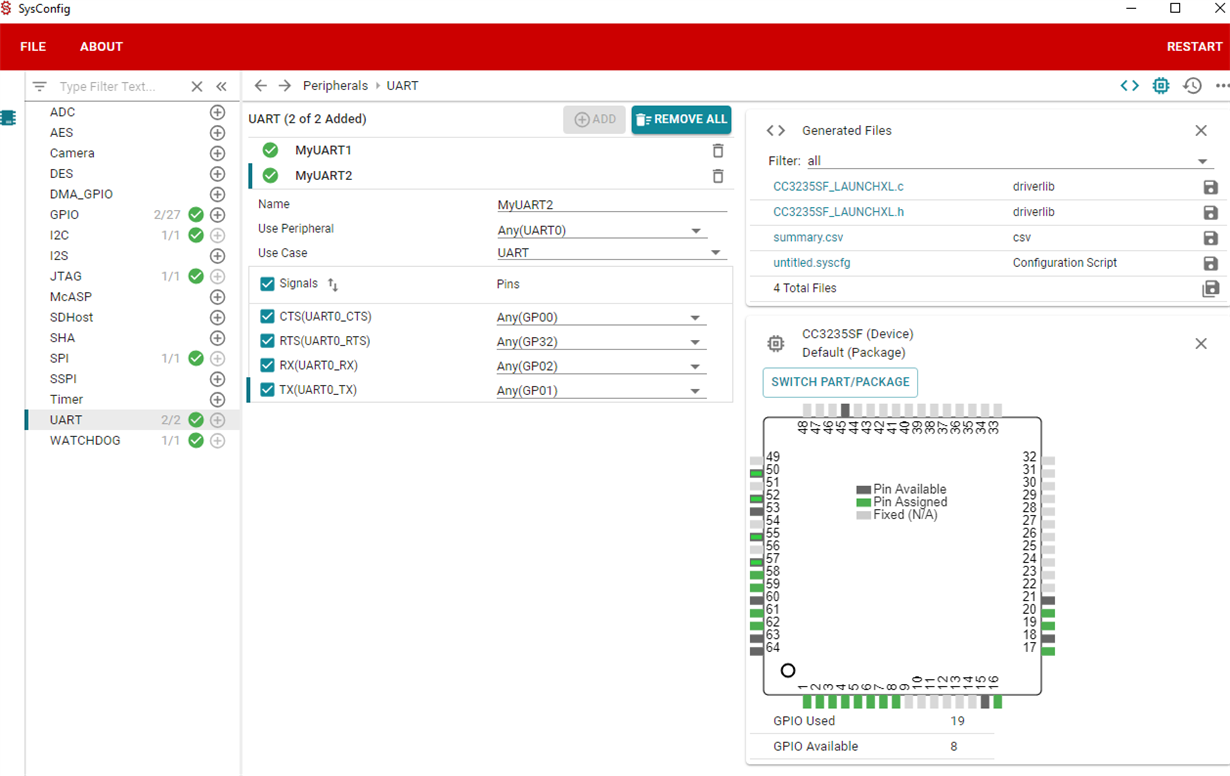

I am using the CC3235SF board and I would like to utilize 2 UARTs simultaneously, based on the datasheet it would be possible to configure 2 UARTs. Using the sysconfig tool I configured the board as I wanted (i.e. 2 UARTs) as it can be seen below:
So in order to use the 2 UARTs, I imported the generated files: CC3235SF_LAUNCHXL.c,  CC3235SF_LAUNCHXL.h.
How can I extent the example code of 'uartecho.c' in order to use both UARTs at the same time?
Also, is there a possibility tha this configuration overlaps with other build in functionality of the board, e.g. switches. ?
Thanks in advance!

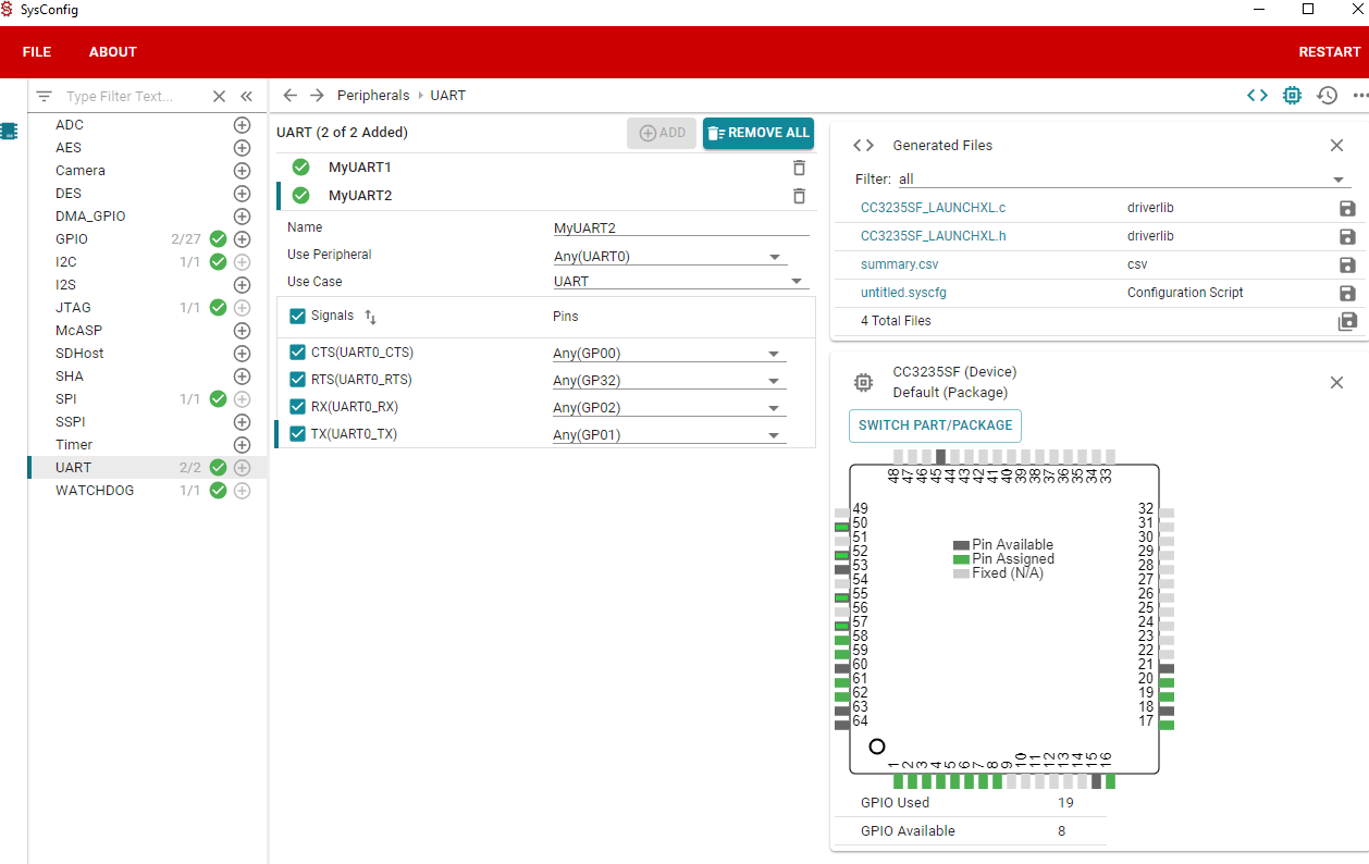

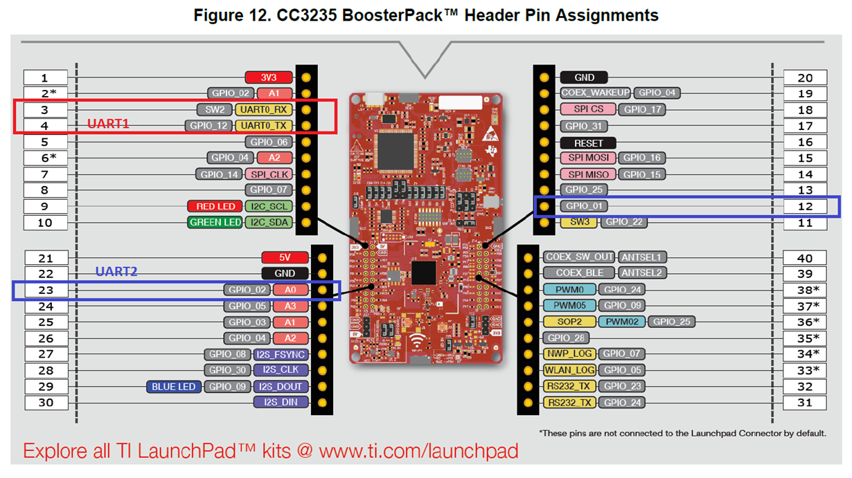

  • Hi Sarah,
    Thanks for the quick reply! I reattached the photo (photo2). Do the pin assignments from the SysConfig tool (photo2) match the pinmap of the board (photo1)?
    Meaning that the pins assigned to RX, TX of MyUART2 = GPI02, GPI01 are indeed the pins in the blue square of photo1.
    Thanks in advance.
    Artemis
  • Hi Artemis,
    Yes, that looks correct. A few tips though:
    • In the SysConfig tool, I highly suggest you use the Software Product drop down to select the CC32xx SDK version that you have installed locally. The updated SDK will show you many more configuration options, including a view of the LaunchPad header pins.
    • Pins 55 and 57 (GPIO1 and GPIO2) by default are tied to the XDS110 debugger on the LaunchPad and can be used to print messages to your PC terminal. If you wish to use these from the header pins instead of through the USB, you need to move some board jumpers. See the CC3235 LaunchPad User's Guide for more details.
    Sarah
