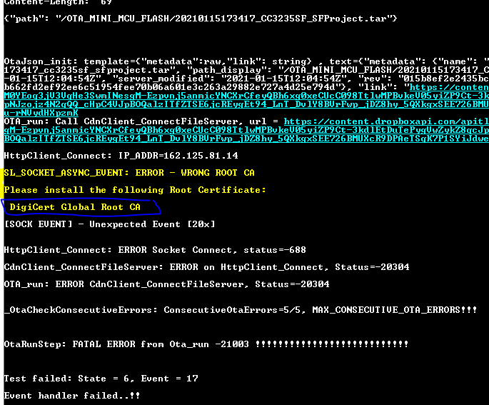

  • Hi Kobi,
    Thanks you so much for being connected, As you told i have added code, it's here
    void SimpleLinkSockEventHandler(SlSockEvent_t *pSock)
        if (pSock->Event == SL_SOCKET_ASYNC_EVENT)
            switch (pSock->SocketAsyncEvent.SockAsyncData.Type)
            case SL_SSL_NOTIFICATION_WRONG_ROOT_CA:
                /* on socket error Restart OTA */
                LOG_MESSAGE("SL_SOCKET_ASYNC_EVENT: ERROR - WRONG ROOT CA\n\r");
                LOG_MESSAGE("Please install the following Root Certificate:\n\r");
                LOG_MESSAGE(" %s\n\r",
                            pSock->SocketAsyncEvent.SockAsyncData.pExtraInfo);
                break;
            default:
                LOG_MESSAGE("SL_SOCKET_ASYNC_EVENT socket event %d \n\r",
                            pSock->Event);
        /* This application doesn't work with socket - Events are not expected */
        switch (pSock->Event)
        case SL_SOCKET_TX_FAILED_EVENT:
            switch (pSock->SocketAsyncEvent.SockTxFailData.Status)
            case SL_ERROR_BSD_ECLOSE:
                LOG_MESSAGE("[SOCK ERROR] - close socket (%d) operation "
                            "failed to transmit all queued packets\n\r",
                            pSock->SocketAsyncEvent.SockTxFailData.Sd);
                break;
            default:
                LOG_MESSAGE("[SOCK ERROR] - TX FAILED  :  socket %d , "
                            "reason (%d) \n\n",
                            pSock->SocketAsyncEvent.SockTxFailData.Sd,
                            pSock->SocketAsyncEvent.SockTxFailData.Status);
                break;
            break;
        default:
            LOG_MESSAGE("[SOCK EVENT] - Unexpected Event [%x0x]\n\n", pSock->Event);
            break;

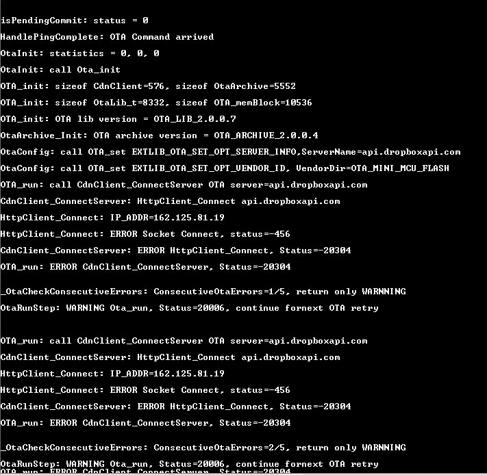

    and when i ran the code , this is what i got.

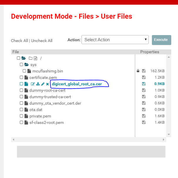

    so i searched for DigiCert Global Root CA in my chrome browser. i exported it in both format
    but no luck.
    Even situation got more worst.
    previously at least i was getting URL, that is also gone.
    please do let me know what else should i try to get rid from this issue.
    sarju bhatnagar
  • make sure you update the otauser.h (i.e. the OTA_SERVER_ROOT_CA_CERT definition should much the path +filename of the certificate)  and the rebuild the library and app (make sure that your library is actually linked with the application).
    If you are able to verify the file content is good (either with openssl or opening it with the Windows "certificate" viewer) than it can only be issue with the file name/path.
    Br,
    Kobi
