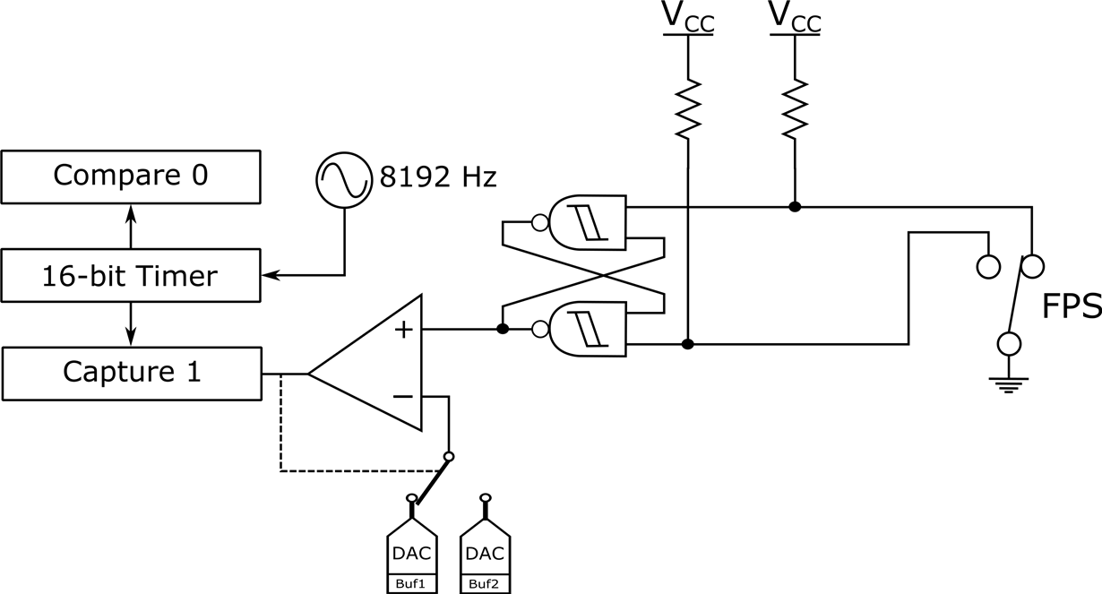

I am assisting a customer to figure out why on some MSP430FR2111 chips the eCOMP does not work as intended. Below is the customers setup :
" The front panel switch (FPS) is debounced by the set-reset flip flop.  The output of the set-reset flip flop is low when the FPS is inactive and high when the FPS is active.  The signal from the flip flop is routed to P1.0 (pin 2 on the MSP430FR2111IPW16R).  The function selection registers (P1SEL0, P1SEL1, P2SEL0, & P2SEL1) are set to connect P1.0 to C0 of the eCOMP module.  The output of the eCOMP module is routed to P2.0.
 The issue is that they have the input P1.0 is working correctly.  When read P1IN BIT0 (P1.0) the signal behaves as expected.  Pressing the FPS the signal goes high and release the FPS and the signal goes low.  They verified this by commenting out the configure of the eCOMP and running a main loop that turns on LEDs if the FPS is pressed and turns the LEDs off when the FPS is released.
They also measured the voltage on P1.0 and found it to go from 0 V to 3.3 V as expected.  That is the signal levels are not in some indeterminate state or voltage level.
The eCOMP module is configured so that when the C0 (P1.0) signal is less than 2.475 V, the output of the comparator should be low (0 V).  When the C0 signal is greater than 2.475 V, the output of the comparator should be high (3.3 V).  However, as soon as the eCOMP module is configured and the module selected, the output of the comparator is high (3.3 V).  This is the wrong output level.  Not sure why this is happening. Pressing the FPS has no effect.  The output of the comparator stays high.
Of the six boards that were built only one worked on the first test.  The other five boards had the issue with the comparator.  After trying several different things, I decided to replace one of the MSP430.  After replacing the MSP430, the board started working. Encouraged by this success they replaced two more MSP430s.  One worked, but the other had the same issue with the comparator.  At this point they had 3 working boards and 3 non-working boards.
They then replaced the MSP430 on the remaining 3 non-working boards.  This includes the one board that they just replaced the MSP430 on. Out of the 3 non-working boards, only one started working.  The board that that started working was the board they had previously replaced the MSP430 on.  It was the third time they replaced the MSP430 on that board.  Now it works.
Although we do take ESD precautions, the customer feels that this might be an ESD issue.  However, it seems unlikely that random ESD events would cause exactly the same failure in these chips. Since both good and bad chips seem to be coming off of the same cut tape, it seems unlikely to be a process issue with the IC "
At this point, the customer has four working boards and two non-working boards.  They are trying to understand what is causing this problem.  So it can be prevented in the future.  The boards have been powered up carefully.  For example the front panel switch is always connected before power is applied.  Furthermore, the serial port is not plugged until the power is applied.  Power comes from the MSP-FET430UIF.
Is this a known issue that you'll are aware of ? I found nothing specific to this in the errata.
