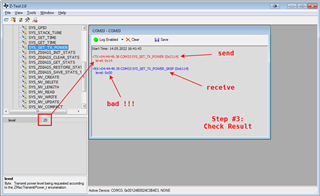

    In the meantime I had success connecting the USB stick with Z-Tools. Here is the result: The stick receives the command but refuses to accept it...

  • Hi Ryan,
    I'm back again.
    Now I tested a value, which shouldn't be allowed: 100 (I tested up to 255; same result).
    Answer = level: 0x00; in your words "not a bad indication".
    is this useful for the CC2652P chip???
  • Although 100 is not a valid transmit power level, it will simply reduce the received value to the maximum entry in the power table.
    static void MT_SysSetTxPower(uint8_t *pBuf)
      /* A local variable to hold the signed dBm value of TxPower that is being requested. */
      int8_t txPower;
      uint8_t status;
      /* Parse the requested dBm from the RPC message. */
      txPower = pBuf[MT_RPC_POS_DAT0];
      status = MAP_MAC_MlmeSetReq(MAC_PHY_TRANSMIT_POWER_SIGNED, &txPower);
      // Send back response that includes the status of the set command.
      // either: MAC_SUCCESS or MAC_INVALID_PARAMETER
      MT_BuildAndSendZToolResponse( MT_SRSP_SYS, MT_SYS_SET_TX_POWER, 1,
                                    &status);
    Ryan
  • Thanks for the explanation, Ryan.
    But what I'm asking now: In which cases is there an error message at all? So another answer than "level: 0x00"???
    Negative or numbers > 255 (more than 2 bytes) will be refused by Z-Tool itself with an error message box.

  • Any value from 0x00 to 0xFF is acceptable for MAC_PHY_TRANSMIT_POWER_SIGNED, thus an error will never be returned by the ZNP.  No parameters are read by Z-Tool when starting, thus all values shown are the Z-Tool default settings at start.
