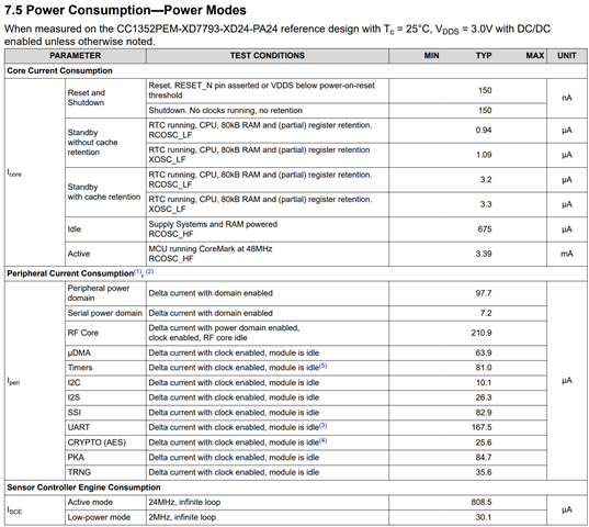

    I measured and it still consumes 260 micro amperes on standby mode
    Haim
  • I recall that you are using a custom board, so this could be greatly influential.  Have you tested power consumption on a LAUNCHXL-CC1352P previously, and has your hardware design been submitted to SIMPLELINK-2-4GHZ-DESIGN-REVIEWS for review from TI's HW engineers?  Given that the current consumption that you are observing (260 µA) is lower than the Idle mode (675 µA) and that your print messages are indicating standby mode, I don't doubt that the device is reaching standby.  However it is uncertain as to whether you've disabled the peripherals which consume power even when idling.
    How are you printing messages, and is it using the Display TI Driver?  What tools are you using to measure power consumption?  Be sure to configure your hardware so that only the CC2652P is being measured. Did you apply "USE CUSTOM BOARD" in SysConfig and have you made any other peripheral changes to the configuration which should be made known?
