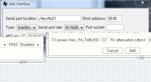

When I tested kit first, EdgeRouter connected 4 nodes, and I confirmed hhrough Nodeviwe.
But to change frequency, I changed interface on user guide p.28.
After than, four nodes not connect to edgeroutert. And the LED on CC1180EM adapters, D1 is active, and D2 is not active.
How to make it connected to the router again?
I found Q&A about AES. But I can not understand. I would like to know how to solve through Nodeview.
Any help would be very much appreciated.
    You need to change the Rf configuration on both the nodes (CC1180DB and CC430xx) and the Edge Router/Access point, and they need to match. You cannot change only the Edge Router and not the nodes, it will result in the beahviour you see. In short (example for CC1180):

    3) Make the same RF changes on the Edge Router using NodeView tool.
    The steps are described on p.28 in section 3.6.2 and 3.6.3 in the User's Guide for the CC-6LOWPAN-DK-868

  • Hi. Thank you for your answer.
    I already changed frequency of CC1180DB nodes. But Edge Router could not connect any nodes.
    I tried both 868MHz and 915MHz on Edge Router using two deiifernt frequency nodes.
    First, I tried one CC1180DB node has not changed anything. That case changed frequency on Edge Router 865MHz to 915MHz.
    Second, I tried other CC1180DB node has chaged frequency. That case also changed frequency on Edge Router 865MHz to 915MHz.
    But both case did not work.
    I think node frequency is not problem.
    Note that the default frequency is not 865MHz, but 868.3MHz. The screenshot in the User's Guide is wrong.
    Please verify RF configuration used on CC1180DB and Edge Router by:
    1) Simply copy the struct you use on CC1180DB and send to me
    2) Log in to the Edge Router and do a cat of the rf_configuration_x file like below:

    I solved that problem. The frequency on Edge Router was the provblem.
    I changed frequency and data rate that you told, both 868.3MHz and 915MHz I confirmed connetion through NodeView.
