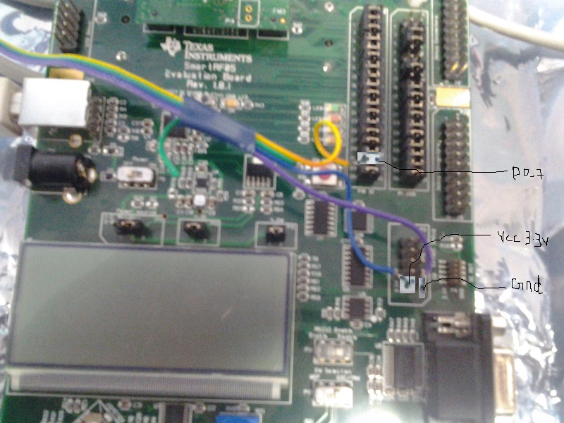

    ii)One more thing i need to ask, you told P0_7 is connected to P10 pin 33. But this Schematic 8863.0724.CC2530EM_1_3_1_discrete_schematic.pdf indicates P0_7 is connected to pin 17 of P1 USB. I didn't from the schematic where the vcc and ground is connected
    Can you clarify my simple doubts

  • 1) This sensor is giving binary data's(10110...). first read will give humidity data, Second read will give temp..  I just want to read a data's from GPI. I used this sensor in 8051 and PIC micro controller.  But i don't to how read in CC2530. Simple question is How can i  read a data from GPI?
    2)Yes, i got it. Then P0_0 is connected to pin 7 of P10, am i right? what about ground and Vcc??

    2. No, P0_0 is connected to pin 5 of P10. GND and Vcc is obvious on schematic. What is your problem about GND and Vcc

    2)I didn't find gnd and VCC in Schematic. Can you tell me where it is connected. I am sorry for basic and simple Question, please clarify my doubt.
  • 1. Yes, you can directly read/write as P0_7 and it is defined in ioCC2530.h.
    2. VCC is on pin 7 and pin9 of P6 and pin 1 and pin 19 of P5 on SmartRF05EB. It is all in SmartRF05 Evaluation Board User’s Guide. Do you really read it?
  • Yes i have seen that in the Table, But i didn't get in the Schematic. I traced for VCC and gnd in Schematic, I found VCC_EM. which is connected to Power supply. I want to connect the Sensor's VCC and GND wire to SmartRF, I found Three gnd in Smart Rf EB, which i marked in Pic
    Can i directly solder a wire in that? Earlier i used Developing board, Which i used do in General PCB. So i request to guide me. Where i can find VCC to connect 3.2v to Sensor.
  • You can use VCC_EM directly. It is on P15.
  • Thanks a lot, One last Question.
    1)As you told i can use VCC_EM directly, There is two pin,pin 1 and 2. I can solder a vcc sensor wire in either pin, right?
    2)And i can solder gnd sensor wire to either 3 side as i mentioned in Picture of last Post??
    Thanks once again
  • Yes for both.

  • I facing a problem here
    /*Check the response*/
    while(!P0_7); //wait till sensor make this line as low
    delay_microsec(80);
    while(P0_7); //wait till again it makes high
    delay_microsec(80);
    After sending Desc Rsp send, ZC is waiting for ZED response, Then i start to Debug, till start signal by CC2230 is running fine. Even in the Check response P0_7 goes low, then CC2530 waiting till P0_7 high, But unfortunately it is not happening. my Connection of Sensor is
    Sensor operates from 3.5 - 5V. I think it can work in 3.3V also. Whether this is causing problem for me? If Yes how can get 3.5V in SmartRf board.
  • 1. I suggest you to use scope to monitor signal on P0_7 and see if it matches sensor data sheet.
    2. There isn't  any power pin can supply 3.5V-5V on SmartRF05EB. I would suggest you to use external power source if you need it.
  • What do you mean by, to use scope to monitor signal on P0_7?, i didn't get this. Can you please elaborate. what should i do?
  • What I mean scope is oscilloscope. Use it to watch the signal on P0_7 and see if it matches the requirements on sensor datasheet.

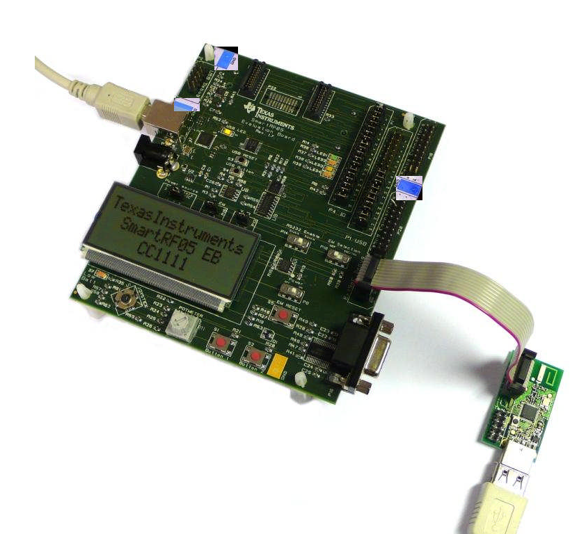

    1.) i have a similary problem. I use the CC1111 and the ADC for reading the temp. over an extern Sensor. But if i config. a P0 Pin over ADCCFG the other P0SEL configuration will overwrite. But i need the other P0 Pins for other things.
    How can i configurate this issue?
    2.) ADCCFG configuration makes a P0 Pin to a analog input? Is that right?
    Becouse i can not reas the Value which the Sensor gives. I use DMA for ADC. Maybe there is something wrong. Here some code:
    DMA config.:
    dma_p.SRCADDRH = ((uint16)&X_ADCL >> 8)& 0x00FF;
    dma_p.SRCADDRL = (uint16)&X_ADCL& 0x00FF;
    dma_p.DESTADDRH = (((uint16)&adc_data) >> 8)& 0x00FF;
    dma_p.DESTADDRL = ((uint16)&adc_data)& 0x00FF;
    dma_p.VLEN = DMA_VLEN_FIRST_BYTE_P_1;
    dma_p.LENH = 0;
    dma_p.LENL = 1;
    dma_p.WORDSIZE = DMA_WORDSIZE_BYTE;
    dma_p.TMODE = DMA_TMODE_SINGLE_REPEATED;
    dma_p.TRIG = DMA_TRIG_ADC_CHALL;
    dma_p.SRCINC = DMA_SRCINC_1;
    dma_p.DESTINC = DMA_DESTINC_0;
    dma_p.IRQMASK = DMA_IRQMASK_DISABLE;
    dma_p.M8 = DMA_M8_USE_8_BITS;
    dma_p.PRIORITY = DMA_PRI_HIGH;
    DMA1CFGH = ((uint16)&dma_p >> 8) & 0x00FF;
    DMA1CFGL = (uint16)&dma_p & 0x00FF;
    ADCCFG |= ADCCFG_5;
    DMAARM = DMAARM_CHANNEL1;
    adc = ADCL & 0xC0;
    adc |= (ADCH << 8);
    adc |= adc >> 6;
    temperature = (adc * 3300)/1023;
    temperature = temperature /100;
    U1DBUF = temperature;
    But i see only 00 on my UART or on my PC.
    What can be worng?
