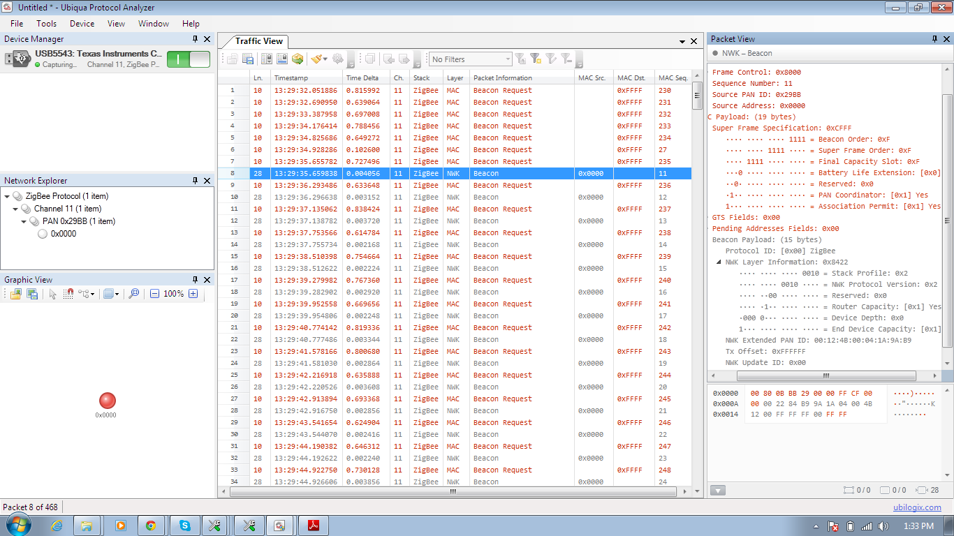

I captured the traffic through sniffer in which it can be seen that network forms ,coordinator also sends ZDP_MgmtPermitJoinReq , then we try to pair end device with coordinator it also send beacon but not joins.
This is what it show in sniffer:

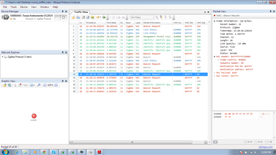

    The coordinator form the network, but end device was not joining and keep searching network as in this image:
    I tried to print device status in ZDO_STATE_CHANGE case for  end device in debug mode ,it is showing DEV_INIT(initialised but not connected ) always ,not going further.
    Also I tried with NLME_Permit_join request , but then also same result as shown in image.
