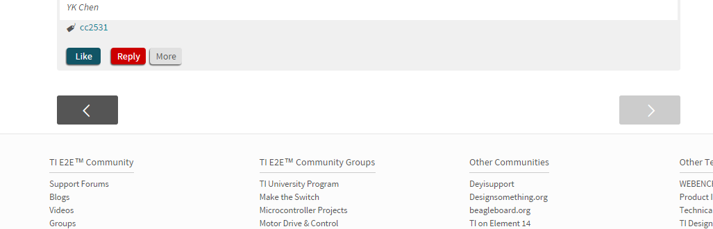

    When you open this thread, go to the bottom of the page, and click on the left arrow (bold gray), all the answers will be displayed now.
    A have attached a picture that shows this arrow.
