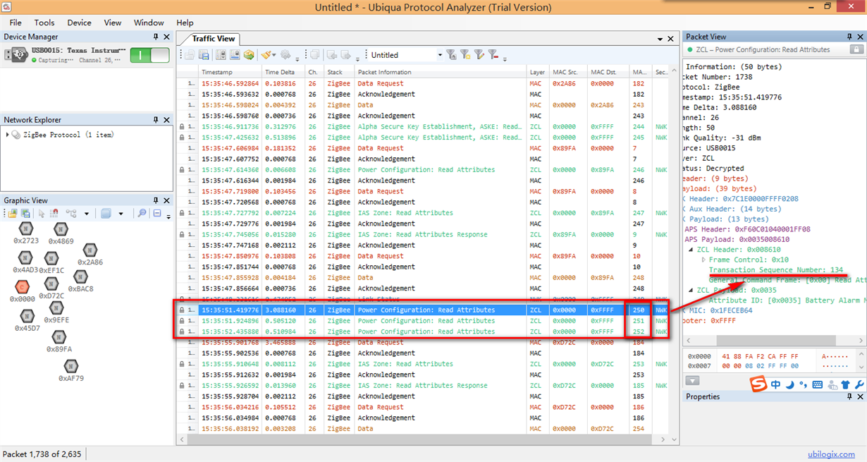

there is a ZC which will send the boardcast msg every 5s 。(those msg was ZCL msg)
i catch the log and found that those Msg always had been boardcast 3 times as there are 3 different MAC seq number.
but their ZCL transaction sequence number is same 。
so is it the zstack default setting that boardcast Msg will resend 3times ?
here it is , 4341.123.rar
i have try several different read attribute CMD, it is same that NWK always being boardcast 3times
but all the zcl transmit sequence number is same 。。。。
