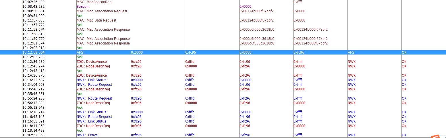

Hi, I would like to know how to join a ZigBee Coordinator as a router automatically without any external input.
I attached my sniffer file here. It looks like there is no signal from my cc2530
Yes, there is only one Beacon request and two beacon frame respond to it. The coordinator enables permit join and device capacity is OK. The problem is that why your device only send one beacon and stop there. Which Z-Stack example is your device based on?
I used Zstack3.0 GenericApp. and in another thread you suggest me using Sample light example

I tried Samplelight. it also only have Macbeaconrequest and beacon. just like GenericApp.
I tried Jason's method in Sample light. And got some sniffer log. It looks like pair successful this time. but it also receive a NodeDecrReeq
what does that mean? I attached my sniffer file here
