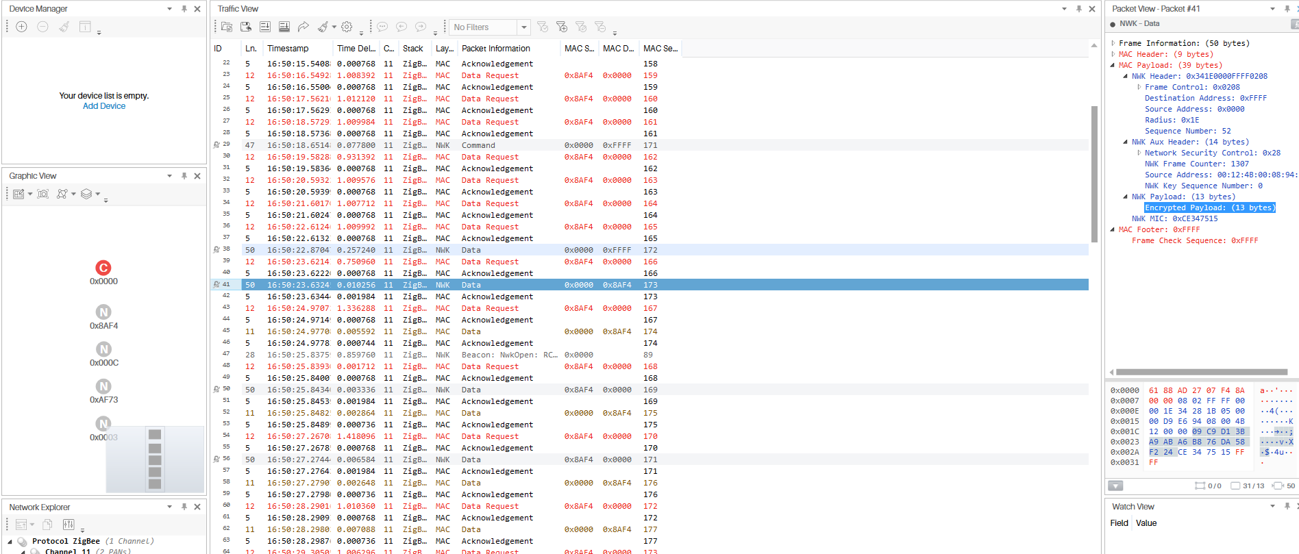

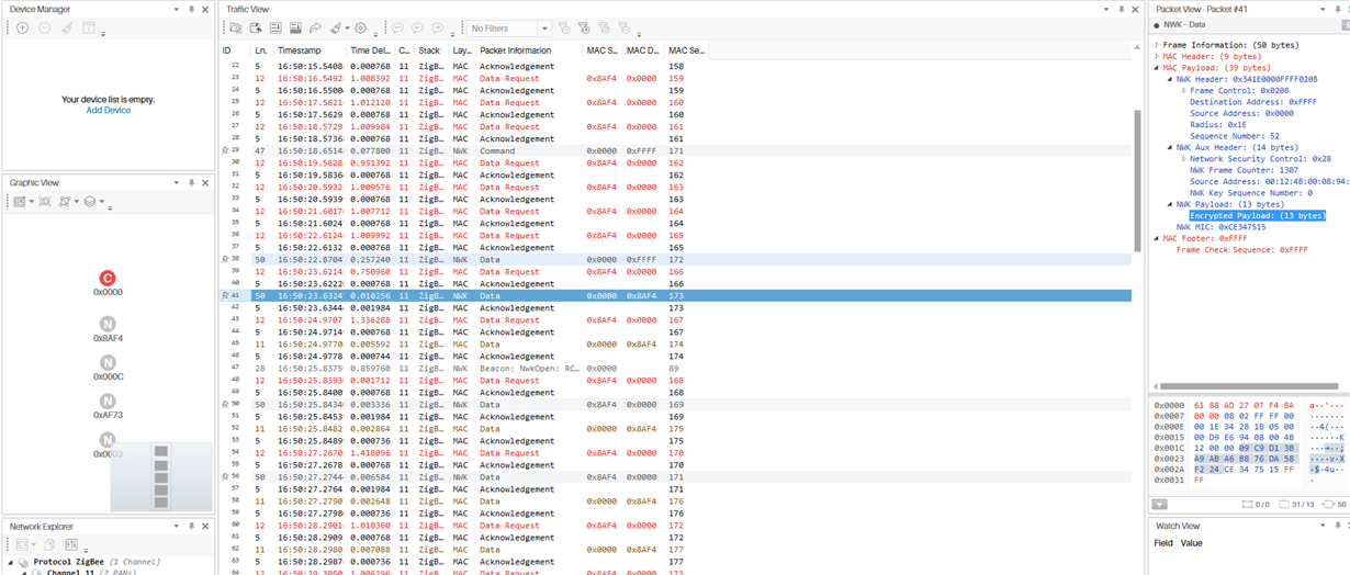

  • Hi YK Chen Sir.
    I have test coord and end device.
    But End device sent to coord beacon request only.
    I attached sniffer log file.
    I don't know reason for it.
    Would you please explain to me for this?
    Please help me.
    Piao
  • I see a device keeps joining coordinator again and again. What coordinator do you use in this test?
  • I have build CoordinatorEB configuration and EndDeviceEB configration in same project.
  • This issue is usually caused by end device doesn't enable security and try to join a security enable coordinator. I suggest you to check this first.

  • Hi YK Chen Sir.
    Sorry for disturb to you.
    I am testing coordinator and end device by using z-stack 3.0.1 now.
    Between Coordinator and end device was connected.
    In the end device is sending data request packet to coordinator.
    So When I press button,coordinator send "ABCDE" packet to end device.
    But In end device get nothing.
    Pls help me.
    Piao
  • sniffer_log2.psd
    I attached my sniffer log file.
    Please refer this.
  • Hi YK Chen Sir.
    Pls help me.
    Thanks in advance. Piao

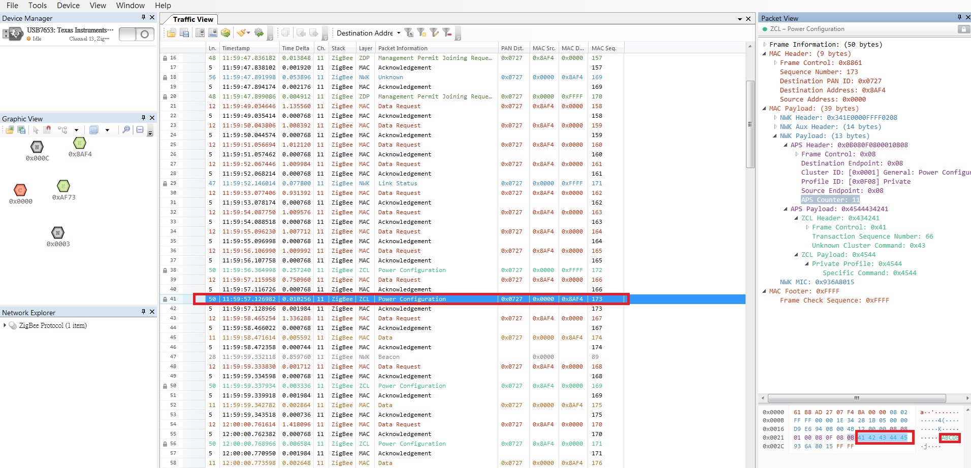

  • If you use the same code, can the message be delivered from device to coordinator? If yes, can you provide sniffer log to show me the result?
  • Hi YK Chen Sir.
    Thanks for your reply.
    Coordinator send "ABCDE" to end device.
    sniffer_log3.psd
    Please help me.
    Piao
  • Sorry , YK Chen Sir.
    I have misunderstand your idea.
    I Will upload sniffer fie.
    Piao
  • I don't see end device sends anything to coordinator in your sniffer_log3.psd.
  • Hi YiKai Chen Sir.
    I uploaded again sniffer log file.
    sniffer_log4.psd
     Following is code send from End device to coord.
    static uint8 SendToCoord(void)
    int nRet = RET_FAILED;
    uint8 data[6] = "UVWXYZ";
    //Unicast
    EasenLock_Periodic_DstAddr.addrMode = (afAddrMode_t)Addr16Bit;
    EasenLock_Periodic_DstAddr.endPoint = EasenLock_ENDPOINT;
    EasenLock_Periodic_DstAddr.addr.shortAddr = 0x00;
    if ( AF_DataRequest( &EasenLock_Periodic_DstAddr, (endPointDesc_t *)&EasenLock_epDesc,
    EasenLock_PERIODIC_CLUSTERID,
    6,
    (uint8 *)data,
    &EasenLock_TransID,
    0/*AF_EN_SECURITY*/,
    AF_DEFAULT_RADIUS ) == afStatus_SUCCESS )
    nRet = RET_SUCCESS;
    HalLedSet(HAL_LED_1, HAL_LED_MODE_OFF);
    return nRet;
    Piao
  • Yes, I can see the message is send from end device to coordinator now. If you use the same code to send message from coordinator to device, what do you see in sniffer?

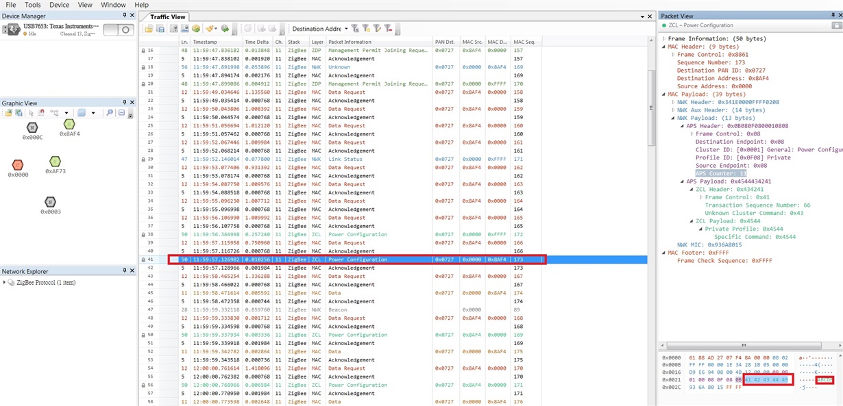

    sniffer_log5.psd
    Piao
  • In your sniffer log, I can see end device receives "ABCDE" from coordinator.
  • Hi YK Chen Sir.
    Sorry , I can't see in my sniffer log fielyou saw .
    Would you please point to me in my sniffer file?
    Piao
  • And Then in my project didn't occur AF_INCOMING_MSG_CMD event.
  • Hi YK Chen Sir.
    Thanks for your fully advise again.
    I analyzed my sniffer log file too.
    But my result isn't equal with your result.
    What is my error?
    Would you please explain to me difference?
