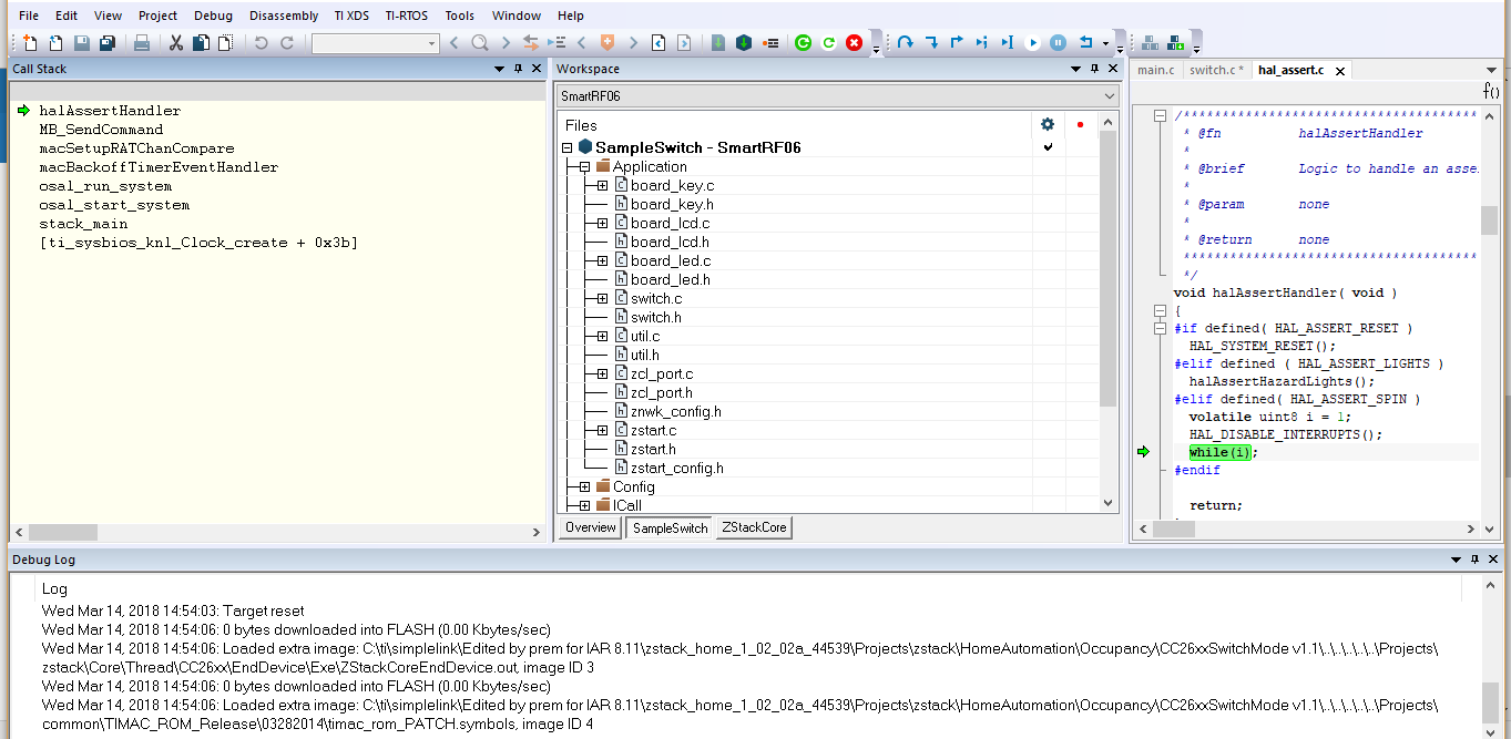

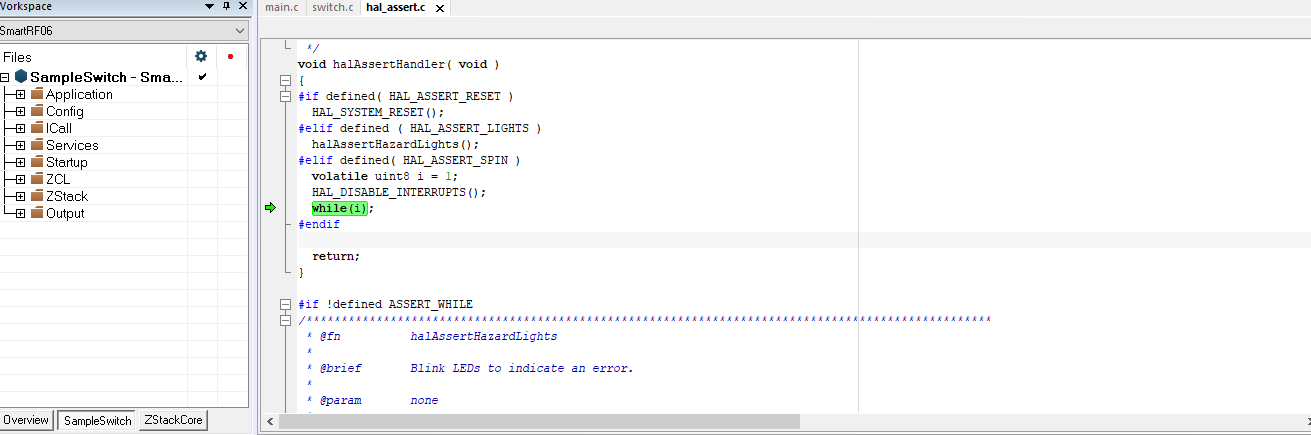

I am using cc2650 5x5 end device with z-stack 1.2.2a sample switch example.
I have enabled " HOLD_AUTO_START". so the device will not start network discovery until unless i trigger intentionally.
But in this case ideally device should remain in sleep mode and consume very less power like few uAmp.
But in My case after some time of power On the end device stuck and continuously consume 5-6 mAmp current.
