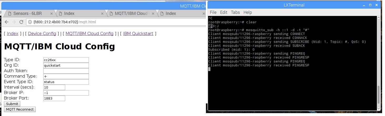

I set Broker IP to ::1 (see the picture below) - is it correct?
The sensortag mote is trying to connect to the broker (see the terminal output on the picture below), but it doesn't happen.
What am I doing wrong? How to make the mote publish to the broker?

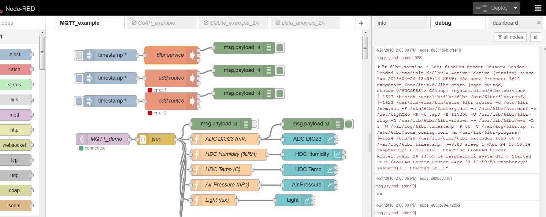

  • yes, if you run the nodered flow I gave you it does it

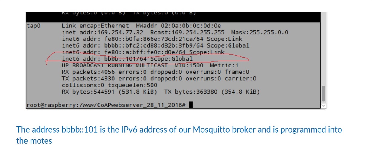

    1)
    from TI processors.wiki.ti.com/.../Cc26xx_sw_examples
    Finalizing Setup
    6lbr (the Edge Router application) on BBB is running in router mode, i.e. the 6lowpan side will get prefix aaaa:: and the ethernet side will get prefix bbbb:: IPv6 routers send out RA/RS to all other hosts on the IPv6 networr. The configuration of your PC should get an IPv6 address with prefix bbbb::, but in order to do so it need to be configured the receive Router Advertisements (RA).
    Unless deactivated, 6LBR will send periodially a Router Advertisement (RA) messages on the Ethernet subnet containing the configured prefix and the route to access the WSN subnet.
    You have to activate the reception of this message on your host :
    On Linux, if your network interface is eth0 :
    sysctl -w net.ipv6.conf.eth0.accept_ra=1
    sysctl -w net.ipv6.conf.eth0.accept_ra_rt_info_max_plen=64
    These commands have to be run each time the interface is restarted; this can be automated depending on your Linux distribution by enabling IPv6 autoconfiguration in your Network Manager.

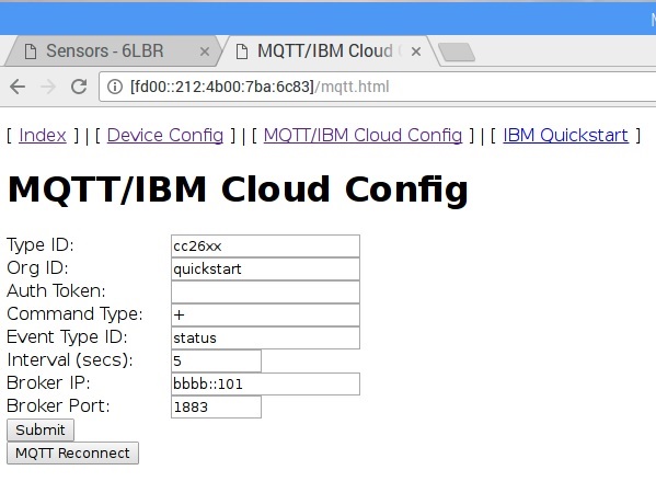

    2) The address bbbb::101 is the IPv6 address of our Mosquitto broker and is programmed into the motes
  • use bbbb::101 to flash into mote as broker IP address

  • once again mqtt broker address you put into nvram of the mote is bbbb::101 (my apologies for the confusion)

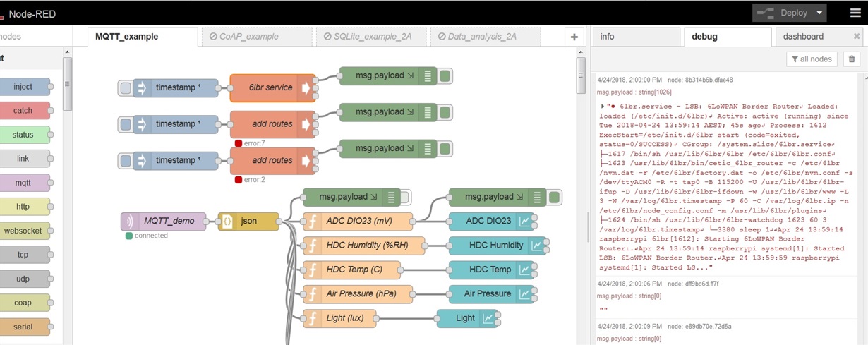

    the routes are executed by nodered - see attached picture
    and I use the 6lbr.conf as attached previously

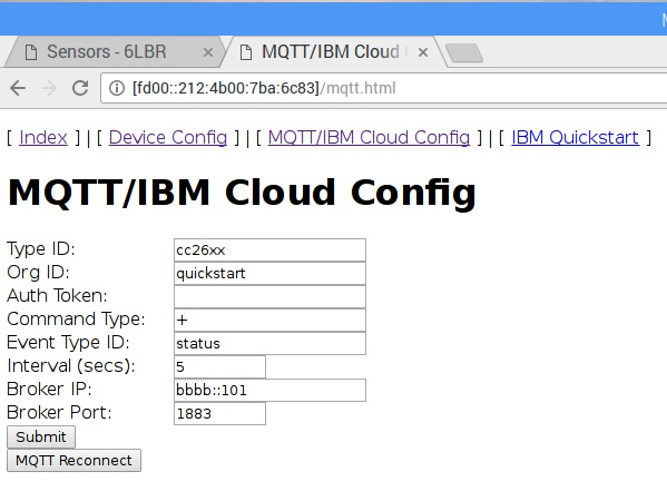

    Do you have the MQTT/IBM Cloud setup as per picture below?
    What is the Green LED on the mote showing?
  • Thanks for your help. After I try to use 6lbr bridge mode, it works now. I will try to give a step-by-step guide on my blog later.
