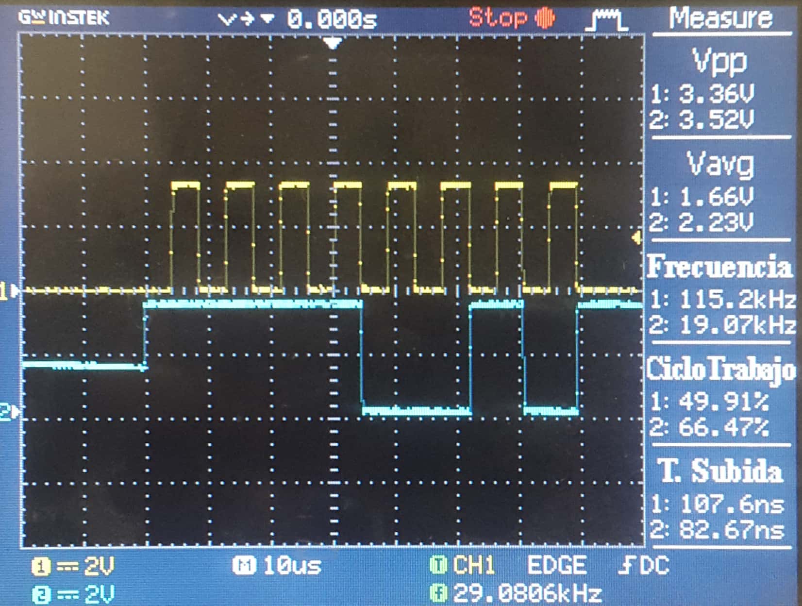

This is my first SPI connection and I have a trouble with my code. I can send and read data from the accelerometer adxl345, when a try to read the register 0x00, i expected 0xE5 but i receive 0xF2, i am using spi 4 wire connection, the SCLK work fine but i can't read correctly. I am using the below code:

The yellow signal is the SCLK and the blue signal is the MISO
