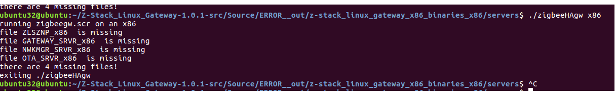

I am trying out sample application 'Zigbee Coordinator Light Example App' , with CC1352R Launchpad, by referring the following guide:
https://sunmaysky.blogspot.com/2017/03/build-ti-z-stack-linux-home-gateway.html#comment-form_1992352146564777383
when i run zigbeeHAgw app, it fails to run and exits complaining that files (listed below) do not exist (missing) :
ZLSZNP_x86
GATEWAY_SRVR_x86
NWKMGR_SRVR_x86
OTA_SRVR_x86
Please refer the following screenshot:

after the 5th steps two files gets in the ERROR_out directory one is  “z-stack_linux_gateway_x86_binaries.tar”  file and another one is extracted "z-stack_linux_gateway_x86" which is blank. Is this in the flow?
Please advise how to resolve the issue.

  • Do you see those x86 binaries under your \Z-Stack_Linux_Gateway-1.0.1-src\Source\ERROR_out\z-stack_linux_gateway_x86_binaries\servers folder?
  • Hello  YK Chen
    This is what i got
  •  Can u check this ??
  • Try to run it with "sudo ./zigbeeHAgw x86" instead of "./zigbeeHAgw x86".

  • After you build x86 binary successfully, you should get z-stack_linux_gateway_x86_binaries_.tar under /your z-stack source installation folder/Z-Stack_Linux_Gateway-1.0.1-src/Source/ERROR__out. Then, you can untar z-stack_linux_gateway_x86_binaries_.tar into your home folder such as /home/xxx/Z-Stack_Linux_Gateway-1.0.1-x86 and switch to /home/xxx/Z-Stack_Linux_Gateway-1.0.1-x86/servers to see those NPI_lnx_x86_server, GATEWAY_SRVR_x86, NWKMGR_SRVR_x86, OTA_SRVR_x86, and ZLSZNP_x86. You can run "sudo ./zigbeeHAgw x86" in the folder.
