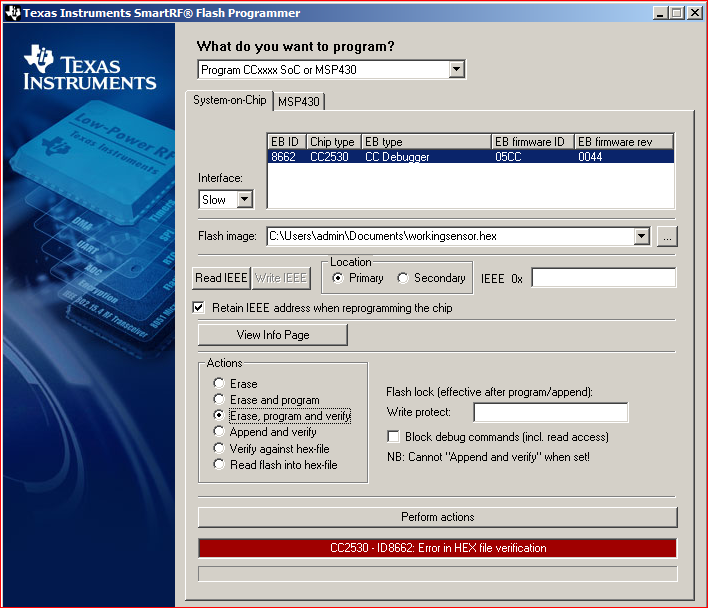

We are having difficulty in flashing CC2530.

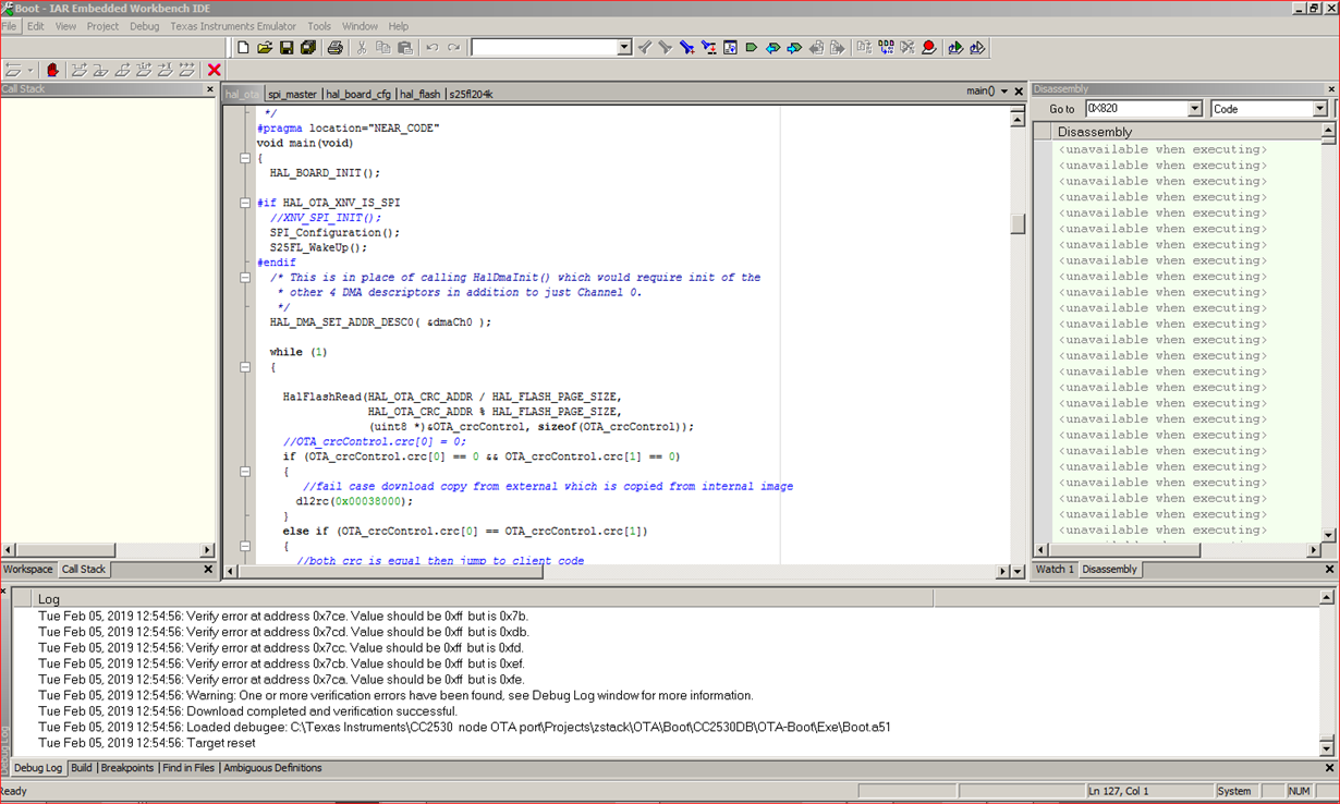

Using IAR it showing "XDATASatck is currently outside of the stack range."
We try to load he using CCdebugger and smartRF flash programmer.I see it able to load file successfully but verification fails.
While we were able to read flash data from chip. We compare it with original it doesn't match.

  • Do you use CC2530F128 or CC2530F256? What hex file do you try to download it into your CC2530 and which example does your hex file is built from?
  • In addition:
    You wrote: "Using IAR it showing "XDATASatck is currently outside of the stack range." This sounds like the hex file has not been generated correctly. Was a file produced when you got this error message? It could sound like YK is on to something, basically that your settings are off.
    You wrote: "While we were able to read flash data from chip. We compare it with original it doesn't match." Are the file you want to upload equal in some parts with the file you read back or are they completely different? If the later it sounds like you haven't been able to flash the device at all.
  • Yes, we use CC2530F256.
    Hex that i try to writeis read from one of my other board in which it works correctly.
    This is screenshot for when i try load bootloader code.

  • We dont understand root of the problem. Either board is faulty or chip. But more or less debugger detect it and write data. But data in flash when we read back it is not match with original at every row values are changed only at beginning some of line written correctly then all are bad.
    we have several non working boards. we also have several working boards of the same type that are working very reliably. In fact design is proven for some time already, only thing is that we have dead on arrival cc2530 ICs in some %. If cc is fine from start then board works quite ok.
    on non working boards we tried to exchange IC around 7-8 times. we used new ic and ic from boards that are working. no luck.
    we replaced crystals. we re soldered crystals. no luck. we don`t see any problem in traces (as explained we have more then one working boards of the same types).
