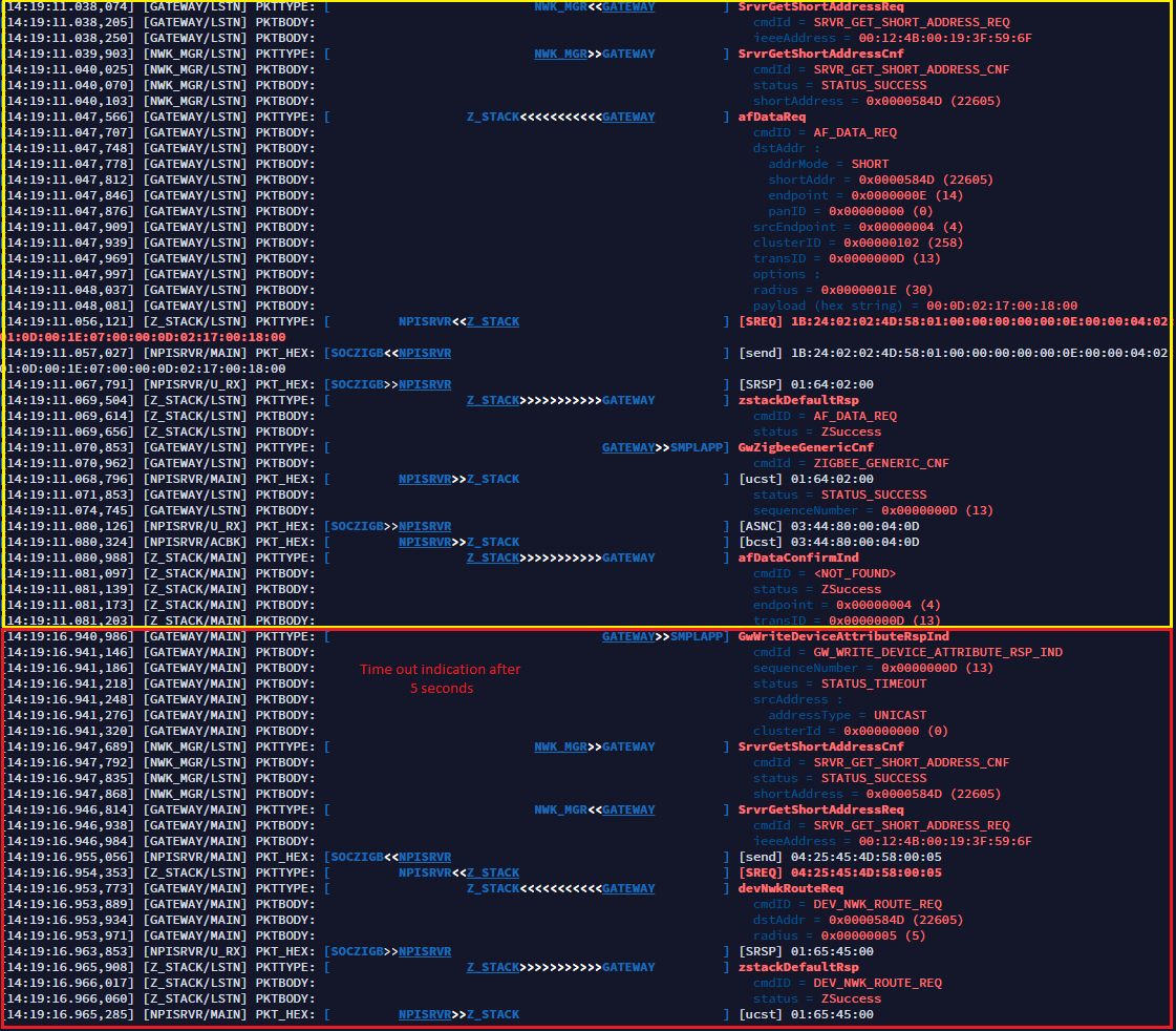

I am working on CC2538 Zigbee Z-stack Embedded firmware.
I am trying to send the Write Attribute command from Zigbee Linux Gateway Application 3.0 to a CC2538 Device.
If I am sending a write attribute command to a device & It was sent successfully over the network.
Device is immediately Responding it with status as SUCCESS.
But on the Gateway Application side, I am not able to receive any kind of indication or response related to it.
After predefined timer interval it will invoke the time out condition.
i.e.
#define DEVICE_TIMEOUT                            5000                             // default = 9 seconds (ms)
#define APP_TRANSACTION_TIMEOUT      5000                             // 15 seconds (app needs to respond to server cmd requests within this time)
I am not getting why this is happening. so I go through logs on gateway application & sniffer data.
& found that my gateway application little bit slower than the hardware device. (i.e. CC2538 router/end device).
Will you please help to solve this problem....
1. how I put some response time delay for the each incoming request?...
 2. is there any another way to handle this condition?...
NOTE : Find the attachment given below for sniffer data & Zigbee logs.
Thanks & Regard's
Shiv Patil.

    I have modified the DEVICE_TIMEOUT and APP_TRANSACTION_TIMEOUT.
    I have tested it for the default values also.
    I am using sniffer to trace the request response sent over the network.
    I am able to see both reports & response for a particular request on sniffer before timeout occur.
    & still gateway server response with the time out condition.
    even I am not able to see any data packet or something information on gateway server console until timeout doesn't occur.
    how can i debug that, Is data received successfully on RF receiving part of ZNP either on UART of beaglebone?...

    We are using Z-Stack 3.0 with CC2538, here we are using CC2538 based ZNP with Beagle Bone, in this when we do write attribute Request from ZNP/Coordinaotor we have a dropage of packets on ZNP due to fast response.
    We have checked on Sniffer where we can see a Success Response for the Write Attribute, but we dont recieve that data on UART of ZNP. We think this problem is due to very fast Success reponse of Attribute Write.
    To check this we have added a small hardcode delay for Write Attribute Response on Router device which recieves the attribute write request and after delay the ZNP recieves the commands properly.
    Can any one help me resolve this issue.
    We added the some kind for hard coded delay on the end device application code to which we are sending attribute write request.
    & we got the response on the znp & on gateway application too.
