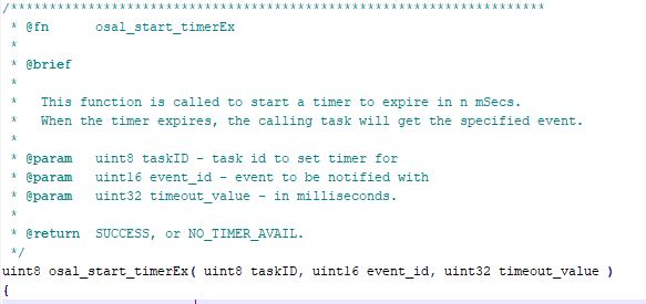

    As you can see below I have check every 100 ms if the button is held after handle key detects SW6, but I believe that I have problem with OSALTIMER, always the "zclTTa0003_OnOff = zclTTa0003_OnOff ? LIGHT_OFF : LIGHT_ON" is hit, even when the button is held for a long time. I have changed the OSAL timer to check from 100 at 100000 and nothing was changed!
    Note: In the OSAL Timer function say that the OSAL timeout value is in milliseconds. as described below:
