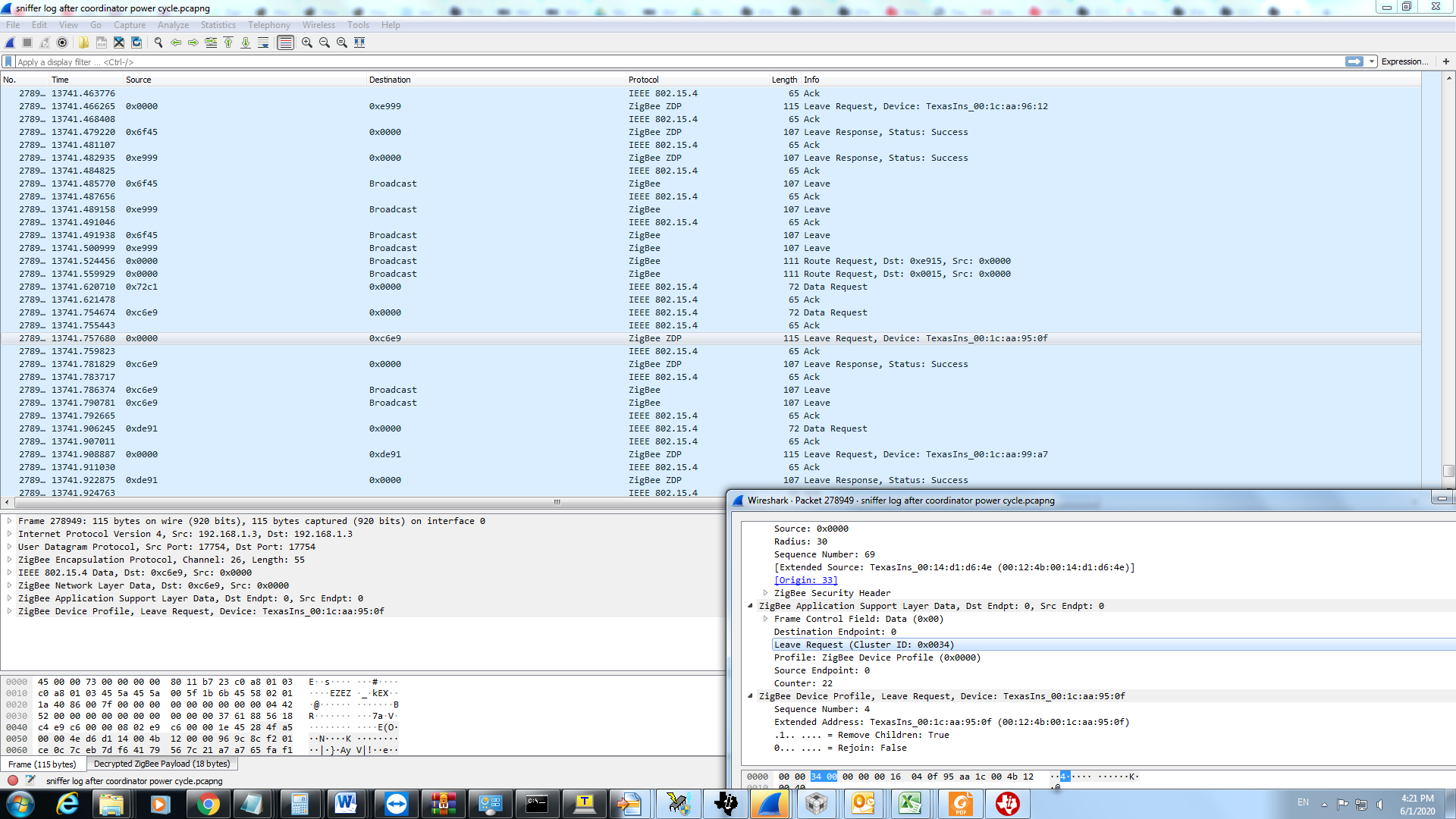

  • Hi Toby,
    Here is the update:
    We connected the coordinator CC2538(zstack3.0.2 ) and CC2652 ZEDs (SDK3.10) for a couple of days.
    It was working initially. Adding ZEDs, sending report, re-join.
    1. After about 2 days, the power cycle hub but the the ZEDs did not notice disconnection (By right, ZEDs should be re-joining(blinking LEDs like the original code)). But the ZEDs is not hang because it can control manually IO to drive an led.
    2. If we power cycle the ZEDs, still not re-joining to coordinator. Not re-joining.
    I attached the sniffer logs.
    Network key: d4:21:5f:b8:b9:72:b1:45:37:93:d7:cd:9f:35:29:77
    https://we.tl/t-S4dxvom7iI
    Walter
  • Hi
    It seems we are getting the leave request from hub and leave response success. What is the purpose of this?

  • Based on this description, we can focus debug effort on the ZC side:
    Since POLL_RATE of original sample code is 1000ms, and your code works with 1000ms, 1., 2., and 3. indicate that it could be the faster poll rate (500 ms) that is causing this. Is there a reason you need to poll this frequently?
    Can you describe what changes you've made to the ZC?
    From the sniffer log, the Parent Annce messages sent by the ZC indicate that the children the ZC keeps track of is not consistent.
    Can you try increasing heap/stack, and nwk buffer sizes on the ZC? You can refer to how this is done in https://processors.wiki.ti.com/index.php/Zigbee_Known_Issues_and_Proposed_Fixes
    Also, since the ZED had received a Mgmt Leave Request, the ZED would've cleared its NV. In this case, after restarting the ZED (eg. power cycle, reset), it would act as a factory new device; try to trigger commissioning on the ZED to join the network again.

  • Hi Toby,
    http://www.ti.com/lit/an/swra615a/swra615a.pdf
    Child Device Management Child management is a procedure for which parent devices must now age out neighbor table entries for unresponsive end device children by a pre-configured default timeout. This aging timeout can be changed per end device upon request from that end device using the End Device Timeout Request command. MAC data polls are sent from a child end device to reset the parent's aging counter. But once the timeout value is exceeded and the child is aged out, the parent will send the device a Leave Request with the rejoin attribute set so that the device may be allowed to rejoin the network through a new parent device.
    We changed the config to original values as zed sdk 3.10.
    But our sniffer log says leave request from ZC with rejoin false.
    Leave Request.docx
  • Correct, and this is exactly the aging behavior seen on the unmodified examples.
    Reverting the ZED to default will not directly affect the ZC's configuration of the leave request; in other words, some changes should be made on the CC2538 ZC. Can you confirm that this issue only happens if you reset the ZC?

  • Hi Toby,
    By right it should be rejoin true so ZED can rejoin back coordinator.
    But, our experience is rejoin false, that s why completely removed.
    Walter

  • Walter's issue is about ZED cannot rejoin network. Not much related to max number of devices.
  • These two issues that are discussed in this thread could be related:
    1. Join more devices to the ZC
    2. ZED unable to rejoin ZC after ZC power cycles (due to Rejoin bit set to false)
    To join more devices to the ZC, you've increased NWK_MAX_DEVICE_LIST.
    --> In addition to this, you should also consider increasing the NV memory region.
    In the post I've mentioned before, there have been cases in the past where, after modifying the ZC to join a large number of devices, resetting this ZC resulted in strange behavior (eg. PANID changed after each reset). This issue was resolved by increasing the NV memory region.
    I'm not sure if you're already implemented the increase to the NV region, but doing so may resolve the issue. Can you confirm whether or not you have inreased the NV memory region?
