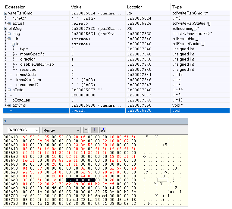

2. zclProcessInWriteCmd(zclIncoming_t *pInMsg)
For this API call, I think there is a NullPointerReference. The variable writeRspCmd is only initialized when commandID is ZCL_CMD_WRITE. However, this function is also process command ZCL_CMD_WRITE_NO_RSP. When it's a NO_RSP command, this variable is a null pointer. However, line of code 4513 directly uses it to write a value. When I run codes in simulator, it crashes and shows me the address is outside range which I think it's correct. However, on CC2538 it has no issues which I think could be wrong.
On CC2538 I send the following message \x08\x01\x05\x00\x00\x00\x00, where frame control is 0x08, tranSeqNum is 0x01, commandID is 0x05. The payload is a write attribute record  where the identifier is 0x0000, data type is 0x00, and attribute data is 0x00. When I debug on both simulator and CC2538, I see the values of writeRspCmd as the following. Based on my understanding, the code should not write to attrList since 0x0000002 is ROM section and read only. The device should crash in this case. However, it executes without any issues.

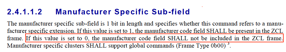

    2. Please further explain this issue by debugging CC2538 hardware (not using the simulator).  The zclFrameHdr includes a two-byte manuCode between the fc and transSeqNum.  I would expect writeRspCmd is NULL and the early return from zclProcessInWriteCmd.

    2. Based on Zigbee Spec, the manuCode is only included if manufacturer specific is set to 1 in fc. If fc is 8 then it means this value is set to 0, so I didn't include manuCode field.
    I use the sample project GenericApp. I use one CC2538 as coordinator to send this command directly with zcl_SendCommand function. When another CC2538 receive this message, I call osal_msg_send(zcl_TaskID, (uint8 *)MSGpkt) to let ZCL process this message. When the program executes, the if condition at line4489 is passed, so writeRspCmd is NULL at line4512 and should return. However, it continues execution the following codes and returns TRUE to zcl_ProcessMessageMSG that means it processes the command successfully. As you said, it should early return a error code or FALSE.

    2. Why not use zcl_SendWriteNoRsp or zcl_SendWriteRequest with the cmd parameter set to ZCL_CMD_WRITE_NO_RSP on the ZC?  Can you provide a sniffer log of the over-the-air communication and debug zclProcessInWriteCmd on your ZED for the contents of pInMsg?

    And here is the sniffer log I capture from Ubiqua. After ZC and ZED are in the same network. I reuse HandleKey function in sample project to send the command message. 8358.Packet.txt
    When I debug, here is the content of pInMsg. Everything is correct (fc is 8, commandID is 0x05, pData is 0). However, writeRspCmd is allocated a memory address(0x200056C4) while the zcl_mem_alloc() inside if condition is not executed in that case. So I don't how it gets a memory. And then attrList is written at line4513. I highlight it in memory view(0x200056C6). But as what we said before, based on the syntax, it should be NULL.

    Can you please provide the sniffer log file instead of a txt?  I do not think you are forming the zcl_SendCommand or zcl_SendWriteNoRsp cmd parameters properly, what is writeCmd?  You can revise the code to not bother with writeRspCmd if the commandID is equal to ZCL_CMD_WRITE_NO_RSP.

  • Since memory is not allocated for writeRspCmd (unless commandID is ZCL_CMD_WRITE) there is no leakage concern.

    Sorry for late update. Yes, I finally found that I set the source end point with wrong variable in the command. But after I set to the right end point GENERICAPP_ENDPOINT, I still see the same result during the debugging. I'm not sure if there is still something wrong with my code, could you help me?
    For my understanding, from user's perspective, everything is correct since no response sent back from the server when sending command WRITE_ATTR_NO_RSP. My confusion is that according to the syntax of that code, from server perspective, when line4512 is executed, an exception or error should occur. However, I didn't see such thing happen when I debug on the device. Is it better to add double check to that function?
