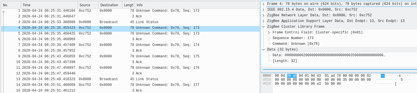

  • Here are the logs.
    case 1:
    • the coordinator requesting attributes from an enddevice worked for a while
    • then the enddevice sent custom commands (which were received correctly and without errors)
    • the corodinator kept requesting attributes, and the sniffer log confirms that they were sent back by the enddevice, it also looks like the gateway server received them, but it only delivered an error message to attr_process_read_attribute_response()  [status != success]
    • as soon as the enddevice stopped sending custom commands, attributes were handled correctly again
    13:52:03.760 >>> ZigBee_EndDevice: requesting attributes

    Can you also provide the sniffer log(s) (and NWK key)? It will be helpful to map ZCL sequence number to what the gateway logs indicate.
    I agree, using custom ZCL commands should not break things. The issue (probably caused by timeout) may be related to a ZCL command sent by the end device in quick succession to the gateway sending the Read Attribute request.
