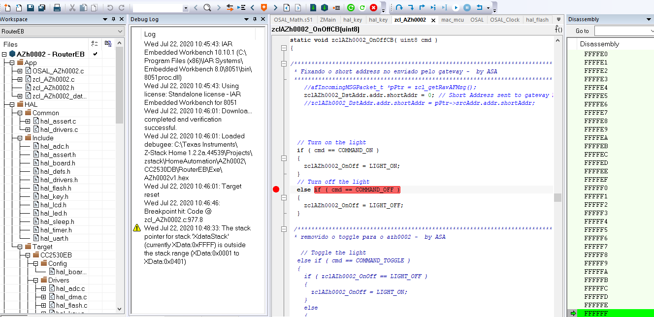

I have tried to follow in the IAR debugging mode, the main root cause, in the different code stages (ZCL.C or my APP files) but I cant do it. I have observed errors like The Stack Data is outside of stack range (0x0000 or 0xFFFF) and the IAR stop debug after it,  as you can observing in the PICs attached.
I don´t know if Stack out-off range is the main problem or consequence, but the intermittency occur since when I burn the code definitely in the CC2530F256 using CC Debugger. Including I have change the Virtual Register to 24 to check if it will fix the problem, but I do not have success!
Someone please can help me and direction to fix it?
 Stack out-of range 0x0000
 Stack out-of range 0xFFFF
 ZCL On/oFF as ON and Reporting Attributs controversial as OFF

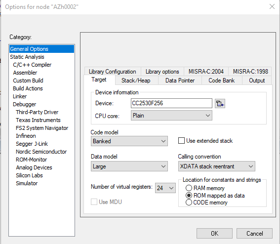

    I´m using TI Z-Stack Home 1.2.2a.44539 version and IAR IDE version 10
    I would suggest using the recommended IAR version as specified in the release notes (<zstack>/Z-Stack Home Release Notes.txt). This may address the debug issues.
    With IAR 10, you may want to consider using Z-Stack 3.0.2 (which recommends IAR 10.20.1 for CC2530).

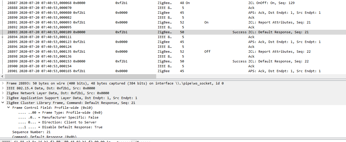

    What happens if you send "on" command a second time? Do you see the Report Attributes indicate that the light is "on"?
    Can you attach the sniffer log with multiple instances of sending "on" command (and Report Attributes)?

    I´m using IAR EWB 10.10.1, as you suggest me, I´ll try to port my on/off device to Zstack- 3.0.
    In response to your question, considering that I have run my device with code inside, without debug mode, after the first "on" command that is no work, some times the second "on" command work or some times not work, it´s totally aleatory. But in the most part of time, the on-off device works after 3 command on consecutive.
    The light is On and OFF in sequence, demonstrating what happens in the messages flow, proving that the device has changed state from "ON" to "OFF".
    You can see more detail in trace log attached and bellow:
    #28887 - The Command  ZCL on/off w/ CMD ON, seq Numb. 129 , sent by GW
    #28891 - Report Attributes On/off CTRL as "ON"  Seq Numb. 21, sent by Device
    # 28893 - Default Response, seq  Numb. 21 sent by GW
    # 28897 - Report Attributes On/off CTRL as "ON"  Seq Numb. 22, sent by Device him self, without any ZCL on/off CMD OFF.
    Note: You can see in the attached trace, at different moments or times, two gateways and my device on/off flows with distinct network short IDs.
    Device On-off in diff moments_w error.zip

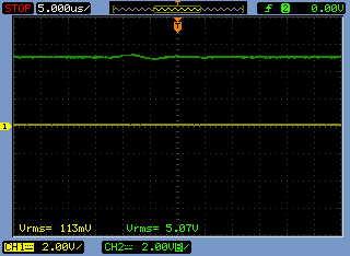

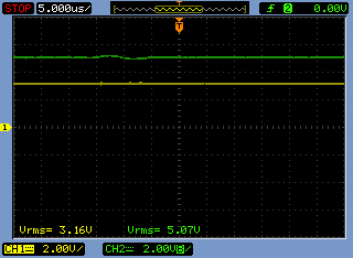

    You can see bellow, the electrical investigation via oscilloscope.
    My Mechanical Key is off
    The Yellow oscilloscope port is connected to opto cuppler connect in P0_4 (switch)
    The Green oscilloscope port is connected to opto cuppler connect in P1_4 (relay)
    My Mechanical Key is ON, please disregards the green line. was too faster to capture it.
