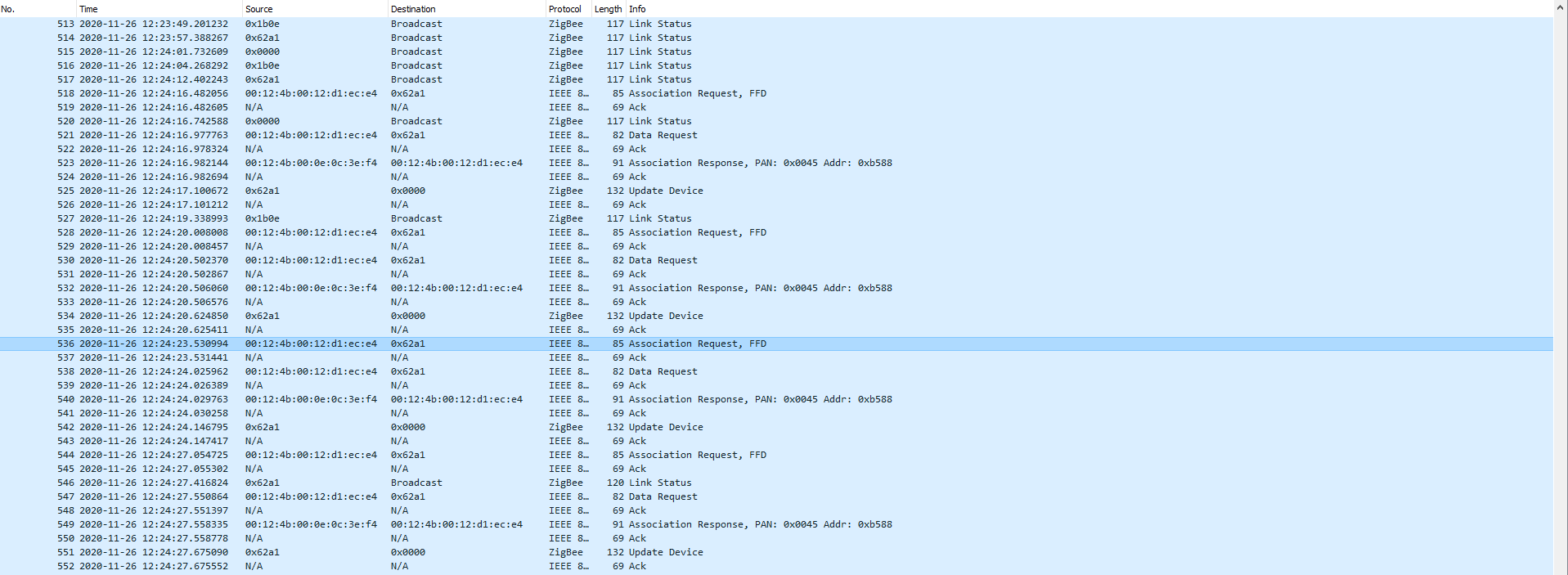

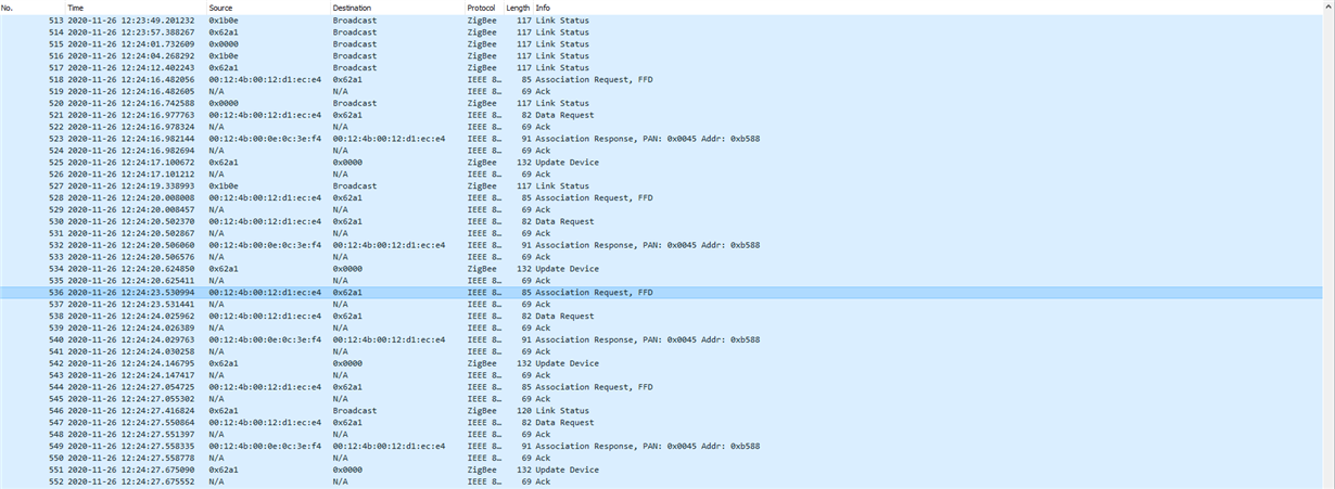

During network formation, we observed that
  • Few ZRs were sending Beacon Request, and the association request and association was successful
  • But after Association response, the network joining procedure ( Device Announcement, Match Descriptor, Transport key check) did not happen
  • This behaviour was observed for different ZRs randomnly
  • The same ZR after sometime would Join the network successfully, (without factory reset, reboot)
What might be causing this behavior (randomnly) ?
Could it be a fault with ZC
I have attached a filtered sniffer log where ZR1 (00124b001fe5d0a5) is trying to join network through ZR2 (00124b001f9e24d3, short addr:930b) several times
Key: 00:01:02:03:04:05:06:07:08:09:0A:0b:0c:0d:0e:0f
Suhrith
  • Hi Suhrith,
    I'm having difficulty parsing your sniffer log.  It would appear that some command is sent from the ZR2 to the ZC but I don't understand why four are sent in quick succession when the ZC appears to ACK the message, plus the data is not correct for the expected Update Device command.  Either way the ZC never tunnels the NWK key.  I've mentioned in a previous E2E thread that supporting 85 nodes with a Z-Stack 3.0.2 CC2530 ZC will not be possible.  You may be able to pick up some more useful network configurations from the Known Issues E2E post depending on the amount of network traffic being processed by the ZC.
