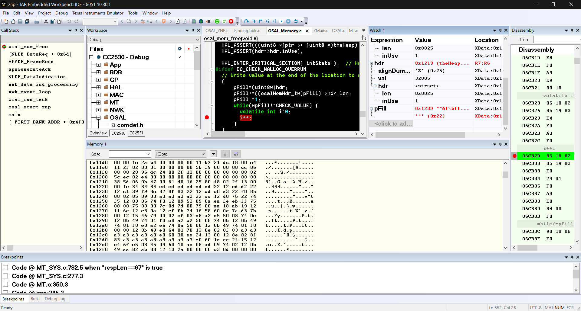

Hi
I instrumented the ZNP code to detect buffer overruns on the ZNP.  See OSAL_Memory.c in the attached ZIP file for the code.
To know when it happens, put a breakpoint on i++ as shown in the screenshot.
The screenshot shows where it happens through the Call stack.
The memory capture shown can also help understand which Zigbee communication caused this, together with the sniffer log.
The serial log is also attached, the serial communication stopped in the extract below:

The method for detecting the overflow/overrun is the following:
1. In osal_mem_alloc reserve 1 extra byte and put a known value in the last byte of the buffer.
2. In osal_mem_free, check the last byte of the buffer.  Enter an infinite loop if the value is not the expected value.
I encourage you to do further tests using this method ;-) , and of course share the fixes as soon as possible.

    The memory check fails at address 0x123D, which is a detection byte.
    hdr is set to 0x1219 and the allocation has a length of 0x25 (header, requested memory and guard byte included).
    So that memory that is being freed ends just before 0x1219+0x25=0x123E (consistent with the guard byte at 0x123D).
    The header is 0x25 0x80, the latter byte indicates that this memory is used.
    The guard byte is 0xDC, which helps find allocated blocks.
    It is filled with (hex):
    25 80 - Header, 0x25 bytes allocated, including header and guard byte.
    48 02 2f 13 00 00 1e 34 34 34 cd cd cd cd cd cd # 0x0248 NWK:0x132f
    22 12 cd d2 22 12 c1 39 f9 8e 82 8f 83 22 12 cd
    e0 a3 22
    f0 - Violated guard byte @0x123D
    85 08 82 85 09 83 a3 a3 a3 a3 a3 22 ee 12 d0 76 - Possible other written bytes
    If 0x0885 would the length, then the header at the of the heap would be 0x123E+0x0885 = 1AC3.
    That's beyond the memory allocated for the heap.
    It was probably the first block filled so far down the heap, I cant find another 0xDC marker.
