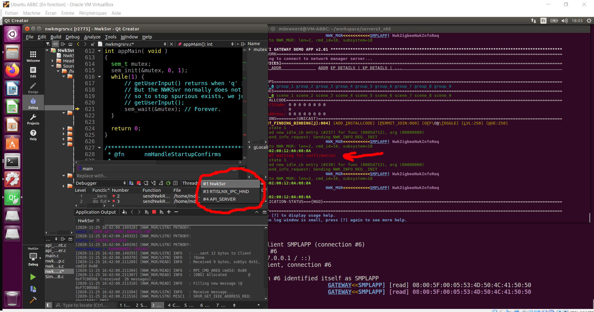

Sometime the application will indicate "TIMEOUT waiting for confirmation" and do so consistently.
It turns out that this is because one of the NWKMGR's threads stopped - normally there are 4 threads.  They were assigned names in my updated code,
So it is the first thread of the two that are created here in "api_client.c":

According to the application output, the end of the thread left no indication of the reason:
[2020-11-25 16:42:00.149355] [NWK_MGR/LSTN] INFO   : ...sent 12 bytes to Client
[2020-11-25 16:42:00.149378] [NWK_MGR/LSTN] INFO   : !Done
[2020-11-25 16:42:00.211289] [NWK_MGR/READ] INFO   : Received 9 bytes, subSys 0x51, cmdId 0x80
[2020-11-25 16:42:00.211304] [NWK_MGR/READ] INFO   : RPC_CMD_AREQ cmdId: 0x80
[2020-11-25 16:42:00.211307] [NWK_MGR/READ] INFO   : [DBG] Allocated 	@ 0xF7C00568 (received  26 messages)...
[2020-11-25 16:42:00.211310] [NWK_MGR/READ] INFO   : Filling new message (@ 0xF7C00568)...
[2020-11-25 16:42:00.211504] [NWK_MGR/LSTN] INFO   : Receive message...
[2020-11-25 16:42:00.211516] [NWK_MGR/LSTN] MISC1  : SRVR_GET_IEEE_ADDRESS_REQ: shortAddr: DB51
[2020-11-25 16:49:57.012509] [NWK_MGR/READ] INFO   : Peer closed connection
As the Network Manager is still running (which can be seen in the UI of the sample applicaiton, everything seems OK while it isn't.
So this calls for some kind of monitoring of the threads, and also identifying the reason why the thread stopped and fix it.
