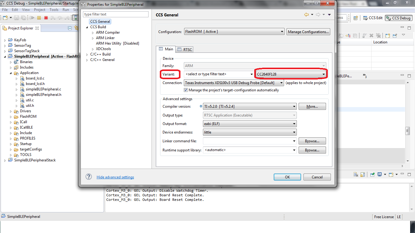

I am also able to flash the output hex file on the board but then the LCD is not showing anything and I am also not able to see any advertisement packets.
I am able to see the Red LED for Advanced Mode ON.
When I saw the Build Option in the CCS IDE, the variant is for CC2640, but I have the CC2650EM-7ID Module on the SmartRF06 Evaluation Board.
So this does not have any issues right (Please see the below snap) ?
I see that the Debugger stops at main(). I am also able to step-in to the functions and step-over the functions.
I am able to go till SimpleBLEPeripheral_createTask(), but then I do not see the SimpleBLEPeripheral_taskFxn() getting called and also the SimpleBLEPeripheral_init().
Please do let me know if I am missing anything.

  • Hello Sunny,
    Please see the sticky CC2640 FAQ thread. It is not recommended to change the CPU variant in the project, please use the defaults. If you have changed it, you'll need to re-import your project to the workspace.

    Moreover, the actual question that I am asking is that the module that I have has CC2650EM while the CCS project "Build Options" has CC2640 mentioned in it. So will it make any problem ?
    Also I am able to step through the main() function via the XDS Debugger present on the SmartRF06 Evaluation Board.
    So can you please let me know if I need to do any other settings regarding the same ?
