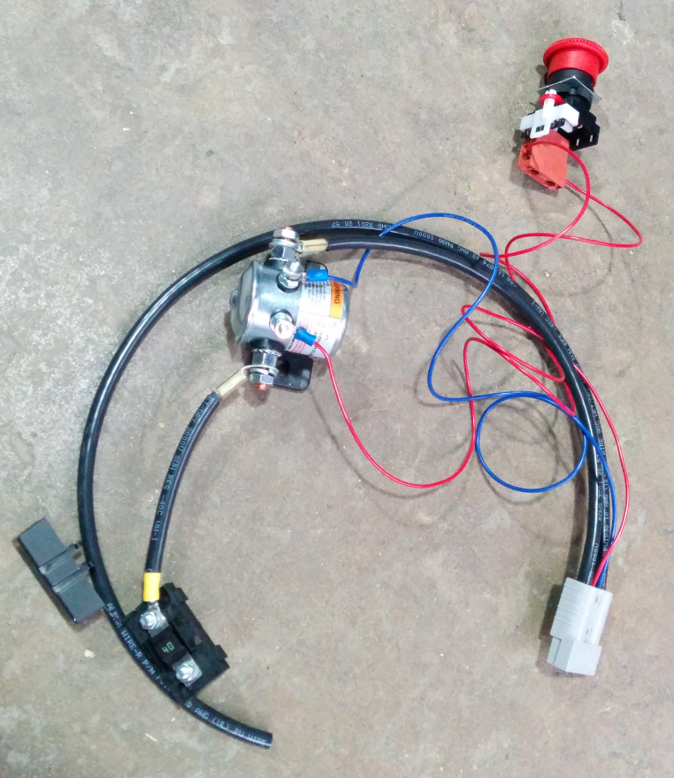

While we as engineers like to take things to extremes, we also like to do so safely (so we can do it again), and safety is an important part of the Power Racing Series. In addition to rules like the standardization of bumper heights and mandating the use of DOT approved motorcycle helmets, there are rules for electrical safety. All vehicles must have properly sized wiring and connectors as well as an emergency-off switch.
Simply connecting an emergency-off switch between our battery and motor wouldn’t work because the high motor currents would destroy the switch. Instead I choose to use a contactor (relay), to control the power to the system. I hooked up the contactor’s coil to the battery and the emergency-off switch. This way, only the coil current travels through the switch and the motor current travels through the heavy duty contacts within the contactor. With a little wire surgery, I was able to come up with this wiring harness:
