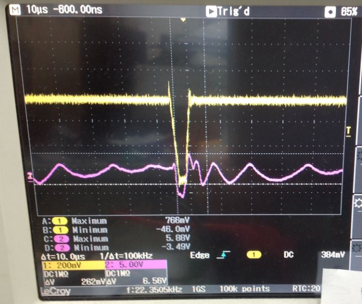

We configure LME49830 to a non-inverting amplifier in DC-coupled setting to drive a capacitive loading which is almost 340nF.
Actually we use this design to drive a 340nF MLCC capacitance  as a dummy loading.
But we find the unstable oscillation shown in below picture...
CH1(yellow) is input signal.
CH2 (magenta) is output signal.
CH3 (cyan) is output current.
We  change the compensation (Ccomp) capacitance from 60pF to 100pF. With this help it can remove oscillation,
but the slew rate is not sufficient neither 60pF nor 100pF condition.
We can't find a combination to satisfied slew rate of 25V/us above.
Is there any recommendation?

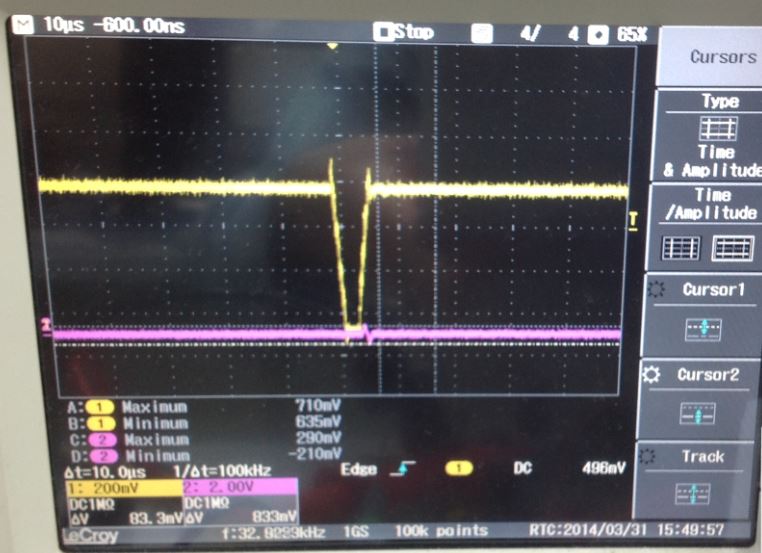

    And I finally found the Vgs waveform of MOSFET is so bad.
    The falling edge is too slow, the rising edge is too fast.
    How can I handle that?

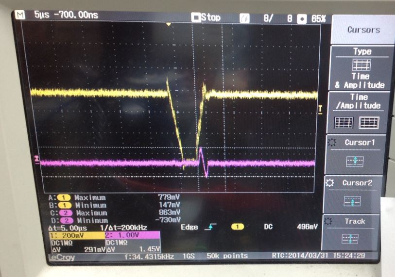

    (A)I remove the bad trace from PCB
    (B)Minimize the glitch, is it good enough?
    (C)Yellow - Input waveform rising edge 2us, hold time 2us, falling edge 2us, Vp-p 0.8V
    Pink - Vgs of MOSFET
    Loading 330nF Cap
    (D) Yellow - Input waveform
    No Load

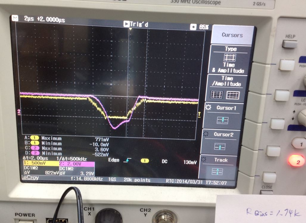

    (E) Yellow - Input waveform
    Pink - Output waveform Vp-p 18V
    No Load
  • Hello Po-Chen-san,
    I'll suggest you couple of thing to have stable output with your C Load condition 340nF Cap load as follow.
    Onyour schematic doesn't have decoupling cap on Vee side. So you should have decoupling cap as close as device pin and Power tr. To get 25V/us of Slew rate, put about 15pF as Cc.  Put 1 ohm resistor in seriese with CLaod as my schematic. And also put 6.8k as Rs to compensate DC offset on + Input pin and GND. Put Pwr Tr AB bias current setting Tr and resistor capacitor ckt ans set Iab on power Tr about 20mA. Then you will have stable output wave form I attached file.  Please visit following URL to check the schematic and output waveform.
