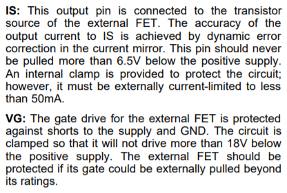

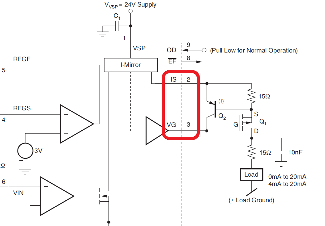

When using XTR111, the definitions of pins 2 (IS) and 3 (VG) are not very clear, how they work and what signals they output. What are the output signal waveforms of the two pins? Could you help me clarify it? Thank you in advance
