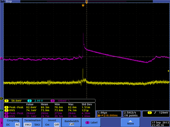

  • OK, the circuit is working, kind of, and I have waveform to share. The yellow trace (channel #1) is the signal with the small pulse and the magenta trace (channel #3) is the output of the peak detector.
    It seems there is a 0.1V drop. That's good. I think I need to increase the signal amplitude, but with only about 80mV, I was able to trigger the peak detector and generate some output.
    Will work on it more, but any thoughts?

  • Hi Jay
    Did you build the circuit on the evaluation board of Ti?or did you build it some other way?
    Kind Regards
    Nico
