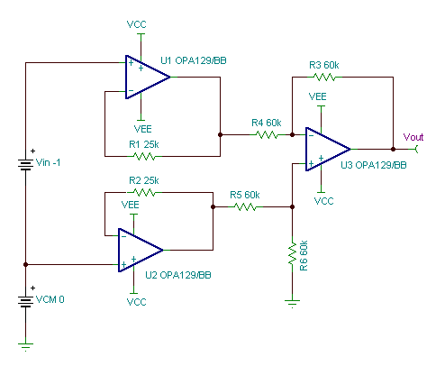

Hi, I am looking for a model (or some fairly accurate model) that I could model the INA116. I would like it to be a bit more realistic than the ideal three amp model, and maybe be able to model the CMR and offsets. The website says that they have a spice model in their TINA software, but I could not find one. (They do have a part for the schematic but no spice model, the webpage lies). I only took Micro I so I don't have a complete understanding of the inner workings of an amplifier. Any Ideas?

  • Steven,
    My apologies for not getting your question answered on your first go-around.
    Unfortunately, we do not have a SPICE/TINA model available for the INA116.  Most customers choose the INA116 due to its ultra low bias current of 100fA.  The only other device that has comparable bias current is the OPA129; therefore, I have built and attached a composite INA116 out of OPA129 devices as shown in the following TINA screen capture:
    If you have any other questions, please do not hesitate to ask.
    Matt
    P.S. Not all of us have red shirts...
    INA116_Discrete.TSC
  • Hi, i appreciate the help, however that model doesn't consider the guarding pins. There is anyway to simulate those pins?. Thanks in advance.
