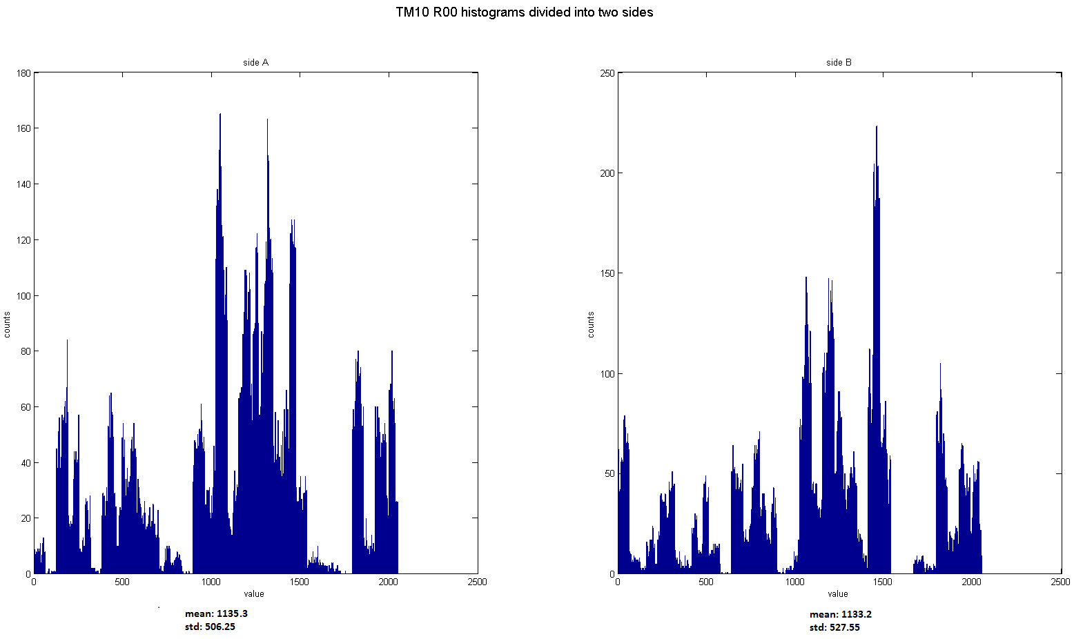

I have a problem regarding DDC316. I have tested two chips and both behave similar.
I wanted to test the chips in TM01, TM10 and TM11 modes (each TM in all ranges - from 3 to 12 pC). I have gathered many data in each mode (eg. 65536) and created histogram of the collected data. What surprised me is that the standard deviation is relatively high. Below is an example of the TM10 test. Please look closely at the R01 (R00 is similar) histogram. Besides values around the mean value there are some peaks from 0 to 2000. RANGE[10] (12 pC) looks completely different and the standard deviation is acceptable.
Basically what I expected from the measurements was gaussian shape of the histograms. It is not only not gaussian, but there are values that are far from the real one (but average value from many data is correct). Without averaging the measurement error is high.
Has anyone had similar problem? I can provide detailed information about DDC316 configuration if needed.

  • Janusz,
    Since we don't offer a DDC316 EVM, I assume you are using your own board? Are the plots including both A-side and B-side data? We know there is an offset between the two sides as mentioned in the datasheet.
    Please let me know your integration time, CLK speed, DCLK speed, and 16-bit configuration settings.
    -Adam
  • Thank you for your reply, it's good to hear from you. Yes, we've manufactured our own board. Below are asked details. Please let me know if you'd like to obtain more information:
    CLK = 39 MHz
    DCLK = 39 MHz
    CONV = 5 kHz (thus tINTA/tINTB = 100 us)
    configuration settings = 1 000 01 0 1 10 0 1 0000 (of course range and TM is programmable).

    Below you can see what happens if we separate data to A and B side. Both integrators behave exactly the same.
  • Thanks for the information. Have you tried adjusting the readout timing relative to the CONV window to see if it changes the output? Also you are not using the internal buffer, could you try using it?
  • What do you mean by adjusting the readout timing? If you mean adding a delay between nDVALID going low and start of DCLK then it's no problem, we can try that.
    It's harder with the internal buffer. We've designed the external buffer exactly as it is in the datasheet (Figure 15). It looks OK for us (maybe we can provide some oscilloscope screenshots, I'll check). If adjusting the readout timing won't work, then we will try to change to the internal buffer, but this will be a major modification and will take some time.
  • Janusz,
    Yes this is what I mean by adjusting the timing. For the buffer I don't think you need to make the big modification, just check with a scope that this signal is consistent.
