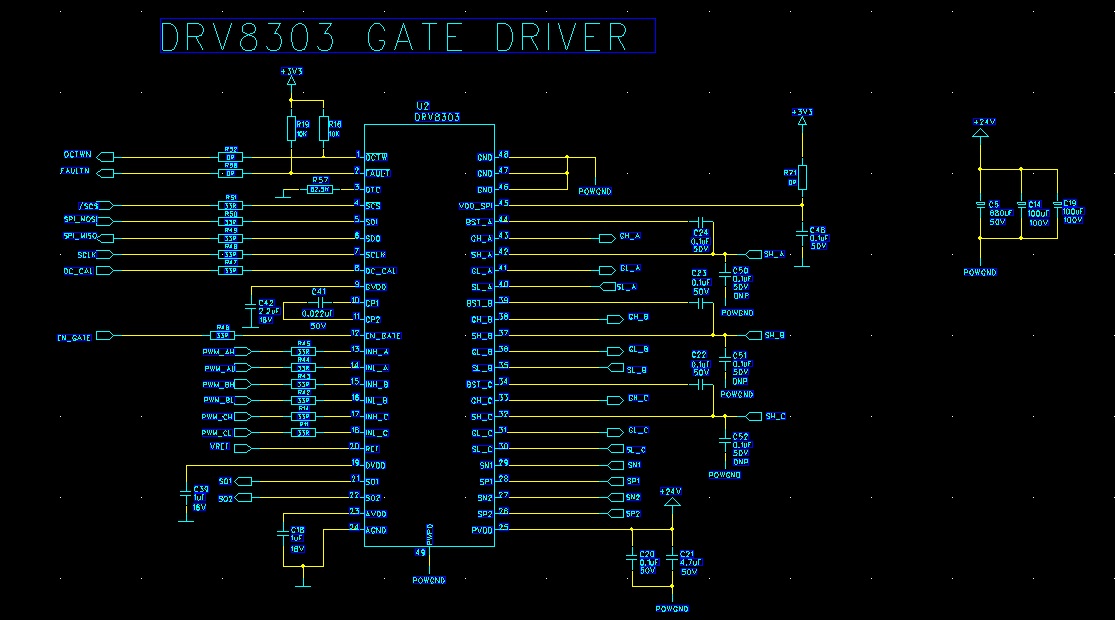

    Is the power pad connected to GND? If not, it must be.
    If you think the schematic or layout could be an issue, can you send the schematics and layout?
  • Hi Rick,
    Yes, the power pad is connected to ground.

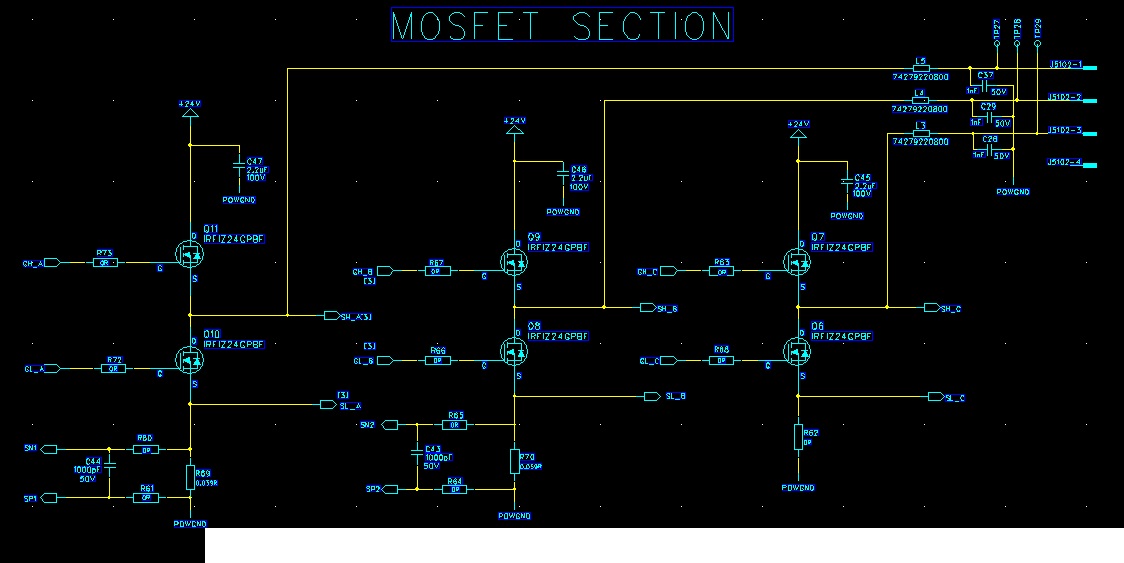

    Please find the relevant schematics below:

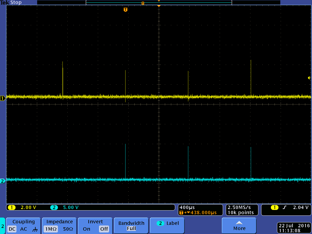

    Below is the capture of nFault spikes (Yellow waveform) and the Gate drive outputs PWM_AL (Blue waveform) . THe PWM inputs are 32kHz square waves. DRV is configured in 3 PWM mode, current limit mode.
    We have zoomed in on the captures of nFault w.r.t GVDD. PVDD and DVDD.
    1) PVDD (Yellow waveform, after AC coupling)  w.r.t nFault (Blue waveform)
    The spikes seen are of a few hundred millivolts, which we believe should not be the cause of an undervoltage lockout.

    There is one item of concern in the schematic. The numbering of pins 19 and 20 are out of order. Please check that the schematic and layout are correct in this area.
    If it is correct, please disconnect the motor and slowly proceed through the procedure to turn on each pair of FETs.

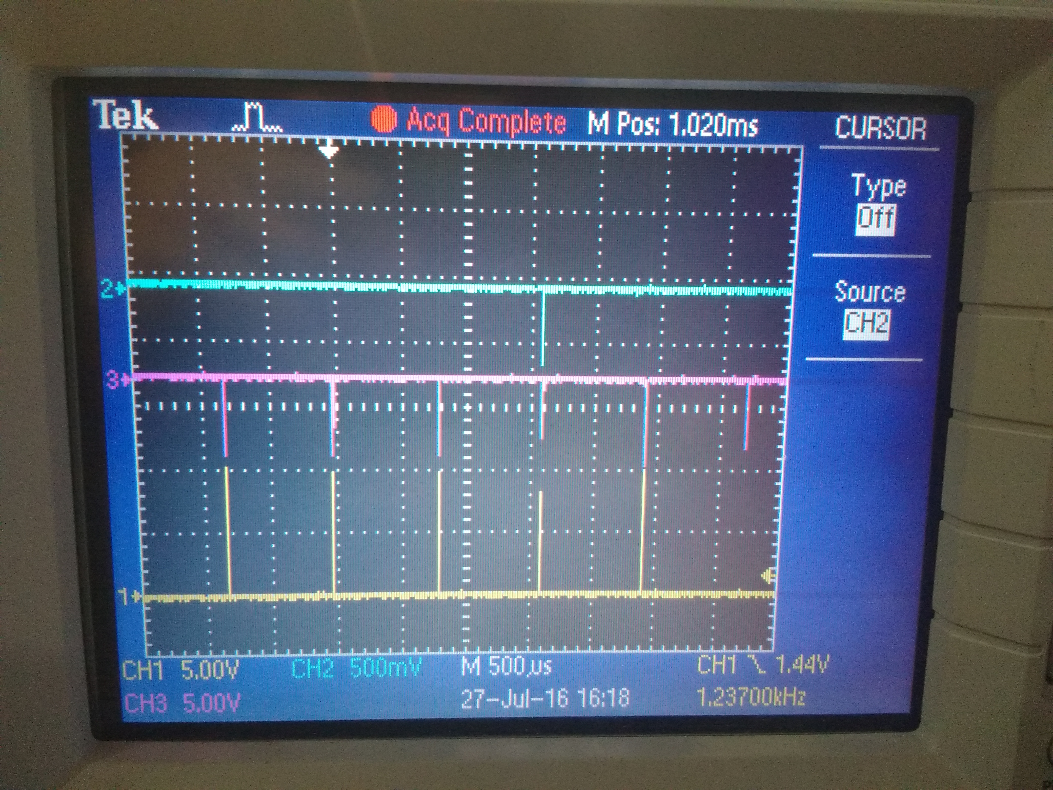

    GL_A : 10.4V rising pulses with ns on period
    SL_A : Spikes falling from 0 to 600mV
    Sh_A : Spikes falling from 0 to 6V
    NOTE : You have suggested that the results for SH_A would be ~0V when the lower mosfet on but we see that before the Mosfet is on the SH_A is 0. When we see gate pulse of the lower mosfet the SH_A is falling from 0 to 6V as shown in the pictures below.
    Query: When mosfet is off are we expecting SH_A with respect to GND to be 18V or 0V since the resistor divider is connected?
    In the images below:
    Channel 1(Yellow) is GL_A
    Channel 2(Blue) is SL_A
    Channel 3(Pink) is SH_A

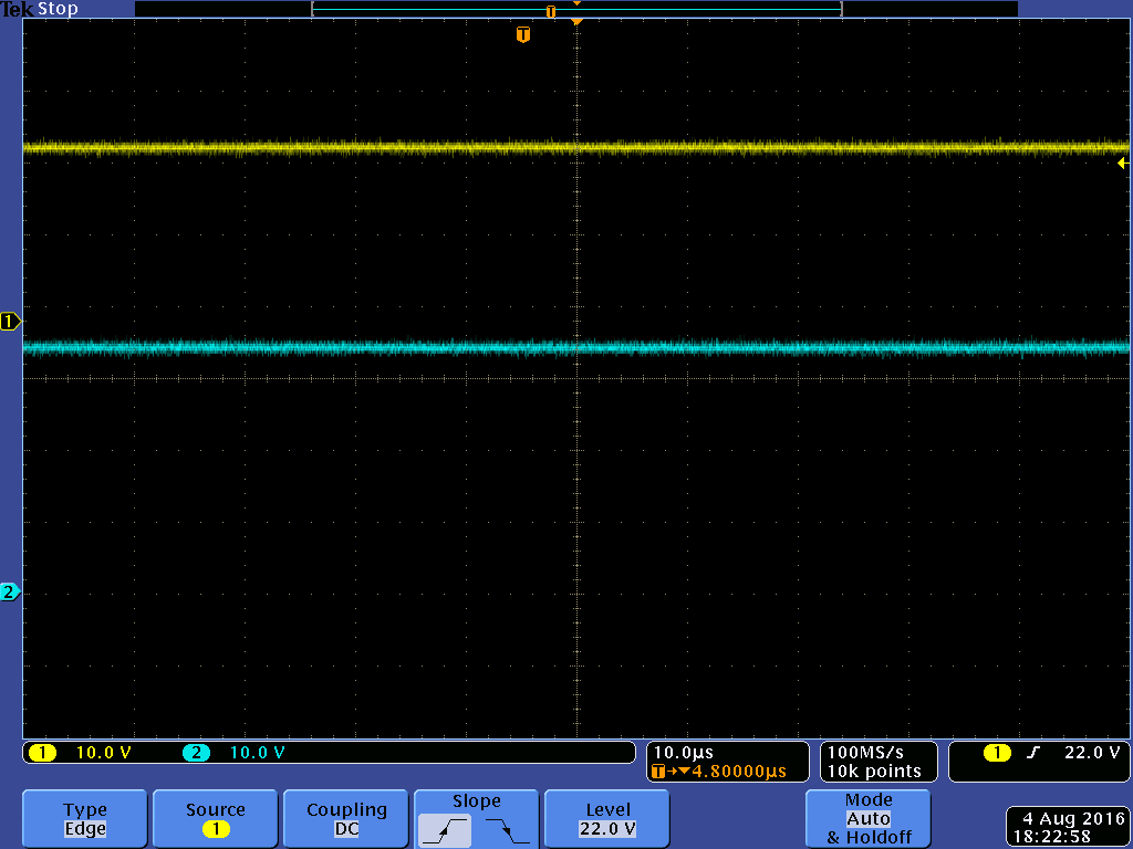

  • Hi Rick,
    Thanks for your help in looking into our design layout.
    Here are few observations regarding bootstrap capacitor.
    Test condition: All 6 MOSFETs are removed from our board. DRV is configured in Current Report Only mode, so no action is taken on OC faults.
    Scenario 1) We disabled gate pulses on a Half bridge (by removing gate resistors of MOSFET) and verified two sides of the Bootstrap cap on that Half bridge.

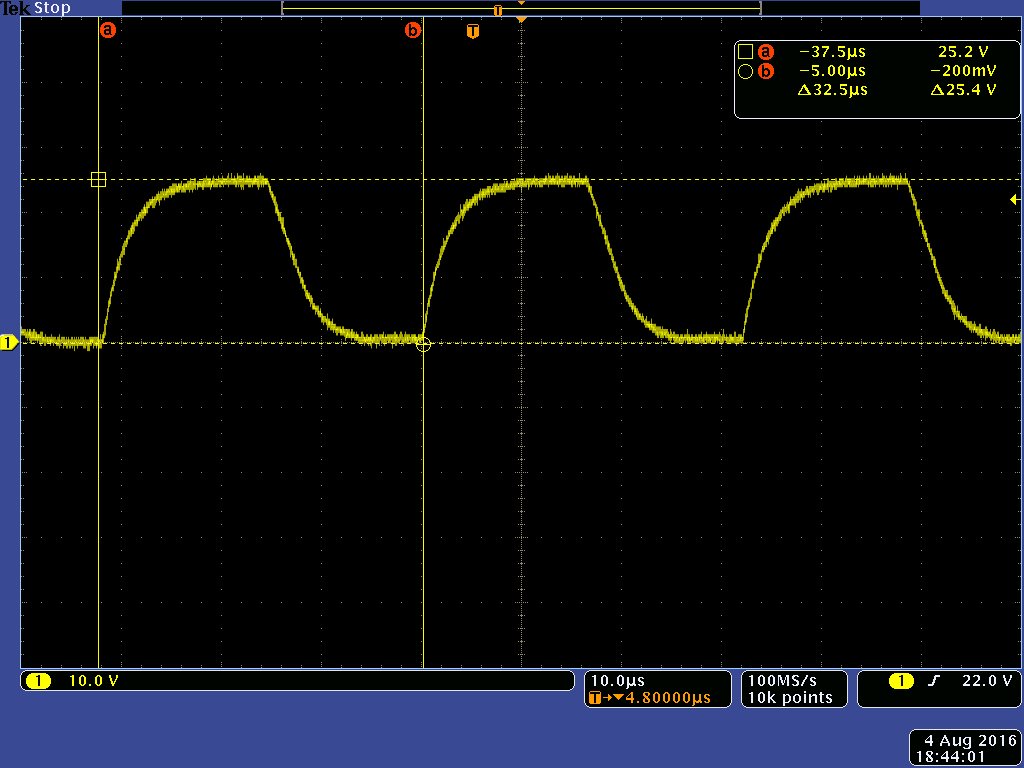

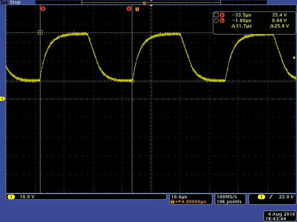

    At the driver side of the bootstrap cap, we noticed a constant DC voltage of around 34V with respect to GND. At the MOSFET side of the Bootrap cap (SH_A) we see 24V DC with respect to GND.
    Scenario 2) We enabled the gate pulses on the MOSFETS of the same Half bridge. (Enabled both High and Low side MOSFETs)
    And on the Driver side of the Bootstrap we see the following waveform with respect to GND:
    On the MOSFET side of the bootstrap capacitor we see the following waveform with respect to GND:
    This is what we noticed without MOSFETs.
    We tried monitoring the Bootstrap cap on our DRV8301 Eval Board where we are able to rotate our stepper motor successfully at lower speeds,
    1) We found that upon Isolating the MOSFET gate from the driver, we see similar DC levels at the bootstrap cap.
    2) Without isolating the MOSFET gate from DRV8301 we noticed PWMs (34V HIGH, 10V LOW)  similar in period and voltage level to that of Gate Drive pulses.
    And on the MOSFET side of the Bootstrap Capacitor  we saw the same waveform with a 10V shift downwards (24V HIGH, 0V LOW). (Similar to above waveforms.)
    Can you suggest what can cause problem in our board having DRV8303? Do you have any tests you would like us to carry out?
    This issue is getting very critical, expecting your continued support.
    Jeeva
  • Hi Jeeva,
    Was the fault removed after removing the FETs?
    If it was, please install each FET one at a time. Then look for a difference in behavior.
    I looked through the schematic again, and noticed the AGND and PGND are not directly connected. This could cause a the voltage on the digital side to collapse. As another experiment, please try connecting pin 24 to pin 49. A good location is the bottom plate of C18 to the thermal pad.
    Have you tried a second board? Does it exhibit the same behavior?
  • Hi Rick,
    Thank you so much for your help.
    As you suggested we have connected AGND and PGND directly and we see the expected output. we have tested on other boards connecting the grounds directly. all boards are working as expected. Sorry for the late reply.
    Jeeva J
