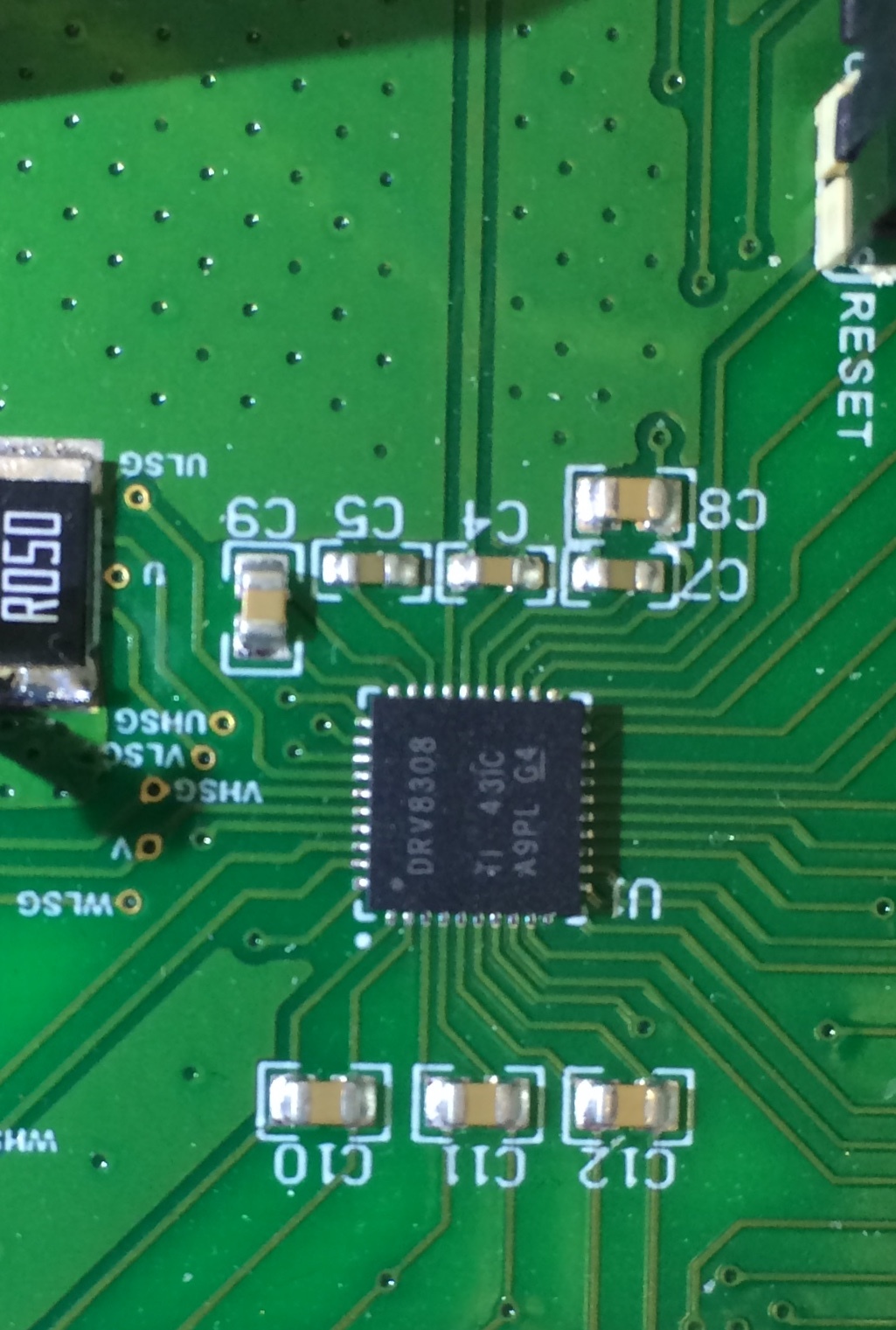

My application requires to change motor rotate direction.  I am wondering what DRV8308's behavior during this transition period with BRKMOD = 1.  On data sheet (Table 5 as I copied in the following), it simply says DIR, brake.  My understand is: when DIR switches, i.e either from high to low or low to high, driver chip will switch into BRAKE mode.  However when it is the condition for the driver chip starts to drive normally.
for example, I run the open loop with pwm duty cycle is set to 10% and motor rotates (BRKMOD =1, brake PIN is not set during the test run).   Then I switch the DIR pin to reverse the direction.  When or under what conditions that 10% duty cycle applies to motor and motor starts to reverse the direction?    somehow I saw a noticeable amount of time that motor being stopped before it reverses rotation.

  • Hi Hong,
    Can you provide either the markings on the top of the package or a picture of the device?
    We would like to determine if you have material that matches revision A or B of the datasheet.
    Once we have this information, we will reply.
  • Hello Rick,
    I think we have version A as I saw the RLOCK fault is set in fault register.  Anyway, please see the image of chip.
    I am in the stage to decide to buy a batch of DRV8308 chips and how can I ensure that I get the version B instead  of A?

  • Hello Rick,
    I have provided the picture of the chip. Is that what you need? what is the expected behavior for both rev a and b chip when DIR flips with BRKMOD = 1?

  • Hello Hong,
    For question #1: Yes, this is expected as current cannot change instantaneously and there will be some time to transition between directions.
    For question #2: Table 5 shows how BRKMOD affect the mentioned inputs. The Direction (DIR) in this case is a don't care condition, whatever the DIR voltage level on that pin is, will just follow the BRKMOD setting. For BRKMOD=0 the motor will COAST regardless of what direction the motor is spinning. Same is true for BRKMOD=1.
    For question #3:  BRAKE can affect RLOCK which is not available in rev B. The complete change from Rev A to Rev B is stated in section 4 of the datasheet. You can also do a Google search for the rev A datasheet, please search: slvscf7a  to obtain the  details for rev A operation.
    For extra question: If you buy directly from the TI store, those parts are guaranteed to be rev. B. We cannot guarantee this if you obtain parts outside TI through a distributor.
    I hope this answers all you questions, thank you.
