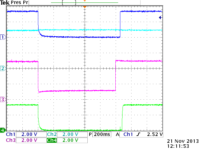

I'm getting random reboots in a BeagleBone Black (BBB revision A5B) with the LINUXEZSDK-BONE v06.00 and powered by an external AC/DC adapter (no USB cable connected).
I have two identical systems under test and I got one reboot each 2 to 3 hours but some days both systems work without reboots for 10 to 15 hours.
I have captured a random reboot with the oscilloscope (see attached image).
    Ch1 → VDD_3V3B (P9.4)
    Ch2 → VDD_5V (P9.6)
    Ch3 → SYS_5V (P9.8)
    Ch4 → SYS_RESETn (P9.10)
The random reboot is produced by 1 second SYS_5V fall therefore seems like the TPS65217C has detected a fault.

  • Hi Antonio,
    A similar issue was reported sometime ago. I will forward this to the factory team to check if there is an explanation already.
        Ch2 → VDD_5V (P9.6)
        Ch3 → SYS_5V (P9.8)
    This appears to be related to USB OTG probing that occurs with the Linux 3.2 kernel. You may want to monitor USB0_VBUS to see what happens during a reset.

  • Hi Yaoming,
    The root cause is the USB OTG driver pulsing the VBUS supply.
