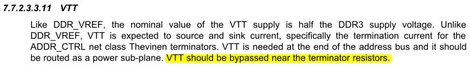

AM335x datasheet (SPRS717J) describes below:
What is the meaning of the highlighted points mentioned above? Does it mean that a bypass capacitor is connected near the terminator resistors?
In TMDXEVM3358 Rev 1.6A, the bypass capacitors seem to be connected near the terminator resistors.
