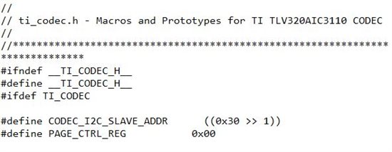

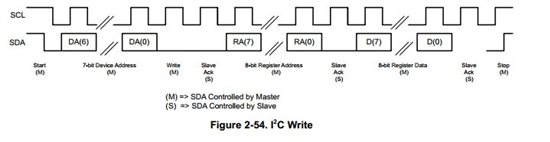

i just would like to ask what is the actual slave address for the i2c in the tlv32aic3204 i m kinda confusing
from the example for evm is
30 00 01
30 = device address
00 = register address
01 = register bit
but when i flip one exam from the CC3200 package i saw that they set the i2c for tlv320aic3110 is 0x30, but in both data sheet mention that they will response to i2c address 0011000 (0x18)
just wanna ask the device address is as same as the slave address or the i2c address is as per data sheet mention 0x18?
can pls clarify
thank
below attached prove
in the CCS for CC3200
