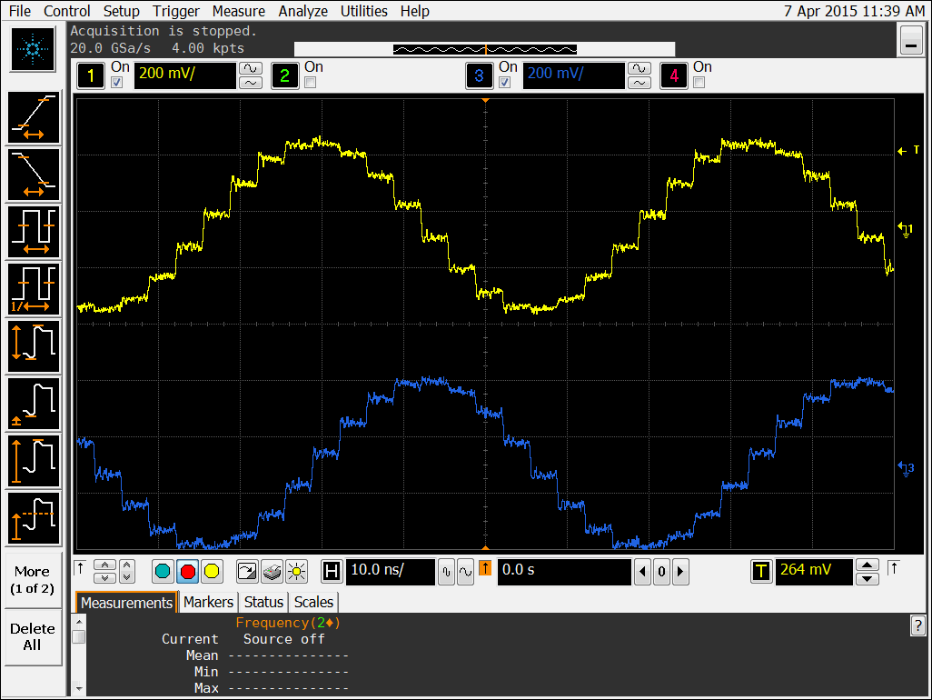

  • Hi, Matt
    the following is the 3 pics I captured from a scope.
    the top one is with interpolation 8,
    the middle one is with interpolation 4,
    the bottom one is no interpolation or interpolation1.
    the DAC clk =2.4G ( I replace the osc on EVM with a 100MHz part), the DAC input data rate = 300Msps. the sine waveform is generated in FPGA with T = 300M/16 = 18.75Mhz.
    so it looks the filtered signal is not so correct, is this the filter setting problem or the SERDES setting problem? I tried to attach the EVM cfg file but not sure it OK or not.
    DAC3XJ8XEVM_vco0_75m_dac2_4G_IF600m_jesd150m.cfg
  • Hi Weiqiang,
    It is not useful to look at a high speed DAC output on a scope. You're seeing the zero order hold output of the DAC. I can't say that this is not correct when it actually may be perfectly fine. You should be using a spectrum analyzer to verify that the spectrum is clean and that the DAC images are sitting at Fs+/-Fin.
    Note that you can't just change the interpolation setting on the DIG BLOCK 1 tab, since all of the clocking needs to change as well - thus the point of the quick start procedure.
    Please review some of the basic DAC concepts in the app note below to understand what you should be seeing at the DAC output.
    www.ti.com/.../slaa523a.pdf
    Matt Guibord

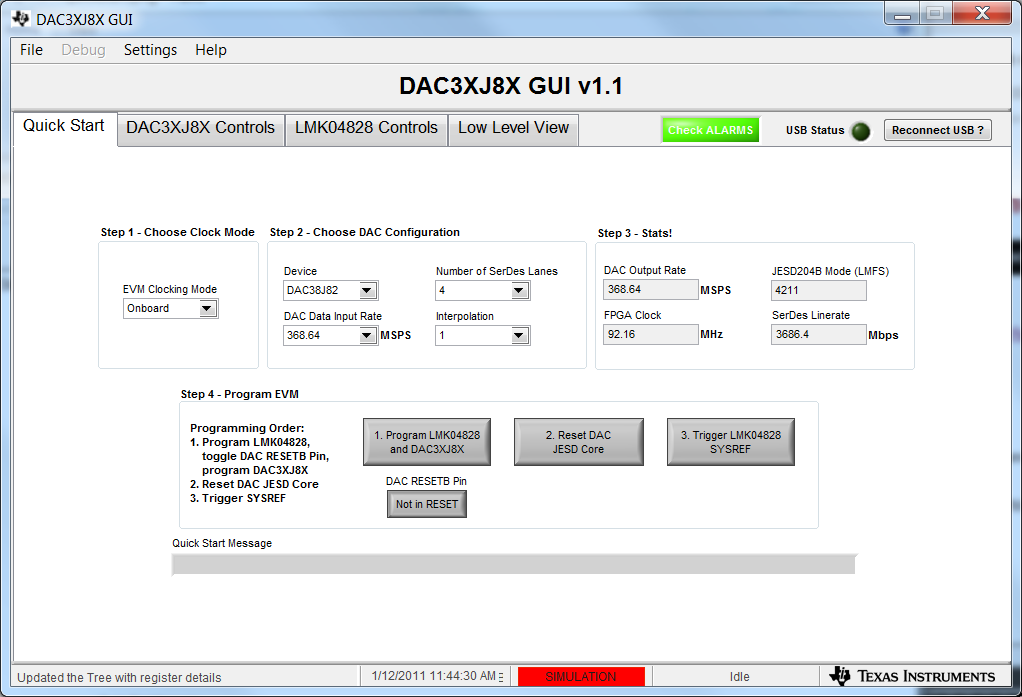

  • Hi Weiqiang,
    Correct, it is controlled internally by a clock distribution circuit in the chip. The internal dividers are set based on the interpolation setting, however you also need to change the serdes reference clock divider and JESD clock divider. Please use the GUI quick start tab. It will automatically calculate the DAC clock dividers based on your data rate, JESD configuration, and interpolation.
    Matt Guibord

  • Hi, Matt
    I use the setup in slau547a (DAC3XJ8X+TSW14J56) to reproduce the issue, and it looks the same as I see in my design.
    a single freq tone  is generated by TSW14J56 EVB and sent to DAC3XJ8XEVM.
    when interpolation 4 is selected, the waveform is good,
    but if interpolation 1 is selected, there should be no interpolation and should see the DAC 16 point samples (368.64M / 23.04M), here only 8 points is shown on the scope.
    the DAC3XJ8XEVM is with the initial setting
    is this correct?
    best regards
    weiqiang
  • Weiqiang,
    Can you confirm that you're setting up the quick start as shown below? You should not change any other parameters in the DAC GUI.
    In HSDCPro you should select "DAC3XJ82_LMF_421" for the DAC and set the data rate to 368.64 Msps. The data format is 2's complement.
    Matt Guibord
  • Hi, Matt
    I think I got the idea, and my design looks OK.
    it looks that the relationship of  "DAC Output Rate" =  "DAC Data Input Rate" x "Interpolation".
    So if "Interpolation"  is changed, the DAC clock must be changed accordingly, is this correct?
    anyway, thanks a lot.
    weiqiang
  • Hi Weiqiang,
    Correct. You'll also need to change the serdes reference divider and JESD clock dividers by the same amount.
    Matt Guibord
