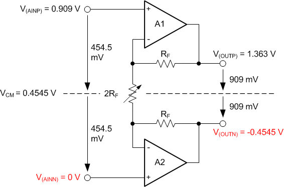

Yash,
This is the exact same question as this following post. Are you two working together?
I'll be a bit more detailed in my answer for this just in case if comes up another time. In this case, the input is outside common-mode input range of the PGA. I'm not sure about all of the setup you're describing, but I'll show a diagram to explain what I mean.
First, you describe using a voltage divider for the 0V to 10V input. Is this the way this is set up?
If this is the setup, then the input is outside the common-mode input range. Note the AINN input. If AINN is connected to ground and AVSS, then this input is outside the input range.
(AVSS+0.1V+(Vin)(Gain)/2) ≤ VCMI ≤ (AVDD-0.1V-(Vin)(Gain)/2)
Assuming AVSS=0V, Vin=0.909V and Gain=2, you get the following if you replace the values in the above equation.
1.009 ≤ VCMI ≤ 3.991
With the input at 0 to 0.909, the common-mode voltage is 0.909V/2 = 0.4545V so the common-mode input voltage is not inside the input range.
The common-mode input range is limited by the input and output range of the PGA. Let's look at a diagram of the PGA. It is shown below.
If you look at the PGA, the amplifiers will still be limited by the supplies going from AVSS to AVDD. Again, lets assume that the inputs are AINN=0V and AINP=0.909V and the PGA is set to a gain of 2.
This diagram shows two things that will be wrong with these input voltages. First, the AINN is too low. Even in a gain of 1, the input must be above 0.1V for the input range of A2. Second, the common-mode is too low because the output of A2 cannot go below the negative rail. The output A2 will be limited to maybe 100mV above AVSS.
So using the voltage divider is not going to work when the negative input is tied to ground (or really AVSS for this example).
There is still a small discrepancy for the second case where the input is driven by the DC calibrator. I'm not sure why this gives you a different result, but I suspect it is the same problem. It depends on the exact setup, but the it could be the calibrator has a different DC offset point, and that it still violates the common-mode range.
The common-mode input range is also addressed in a different post listed below. There is also a presentation that gives a couple of examples of how this is limited based on the input PGA limitations. You can find it as an attachment to one of the posts.
I'd read through this post, and the presentation. If you have any more questions, I would also include a diagram of your setup. It's important to note exactly what voltages are seen by AINN and AINP separately.
