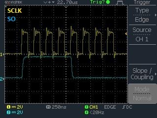

    For testing purposes I am trying to measure 2.5V with only one ADS131E04. With RDATA so I can get data perfectly, but with the RDATAC so I can not get correct data.
    I've attached my electrical schematic, and images of SPI communication.
    I want to set the ADS131E04 to 4 channels, internal reference 4V, internal clock and 64ksps.

  • Hello Brian,
    My Oscilloscope has some limitations, so I can not get a complete data transfer with a good resolution.
    But I can show you a part of that transfer through the figure attached.

  • Hey Carlos,
    I understand now what the problem is. You are not shifting out data quickly enough and it is being overwritten by subsequent samples. You can really see this in your second scope image above. The period between DRDY edges will be roughly 16 us when in the data rate you have configured the device to. It takes you 44 us to shift out data. This means that your data will be corrupted when the next DRDY pulse occurs.
    The reason this works fine in SDATAC mode with the RDATA command is that the device does not automatically load new data into the output shift register in that mode. However when you use that mode, it's likely that you are missing samples.
    To fix this you will have to make your SPI routine much more clean; you will need to trigger quicker on DRDY, reduce the time between SCLK bursts, and perhaps make SCLK faster. Alternatively you could use a slower data rate.

  • Hey Carlos,
    Let's go through the math:
    The sample period for the 64 kSPS data rate is 1/64,000 = 15.625 us.
    The period of a single 8 MHz SCLK period is 1/8,000,000 = 0.125 us.
    If you collect 4 channels @ 16 bits each + a 24-bit status word, you must shift out a total of 88 bits
    88 bits @ 0.125 us SCLK period comes to 11 us.
    That 11 us MINIMUM possible time for shifting out SCLKs is very close to the MAXIMUM allowable 15.625 us. This means that virtually any delay in SCLK when collecting data from when DRDY deasserts could corrupt conversions. To verify this, look at the scope with one channel on SCLK and DRDY on the other and I think you will see that SCLK takes too long to finish.
    Could you use a frequency between 8 MHz and 16 MHz or does it have to be a multiple? 16 MHz is too fast for the ADS131E04's digital output buffer.
    Brian Pisani
