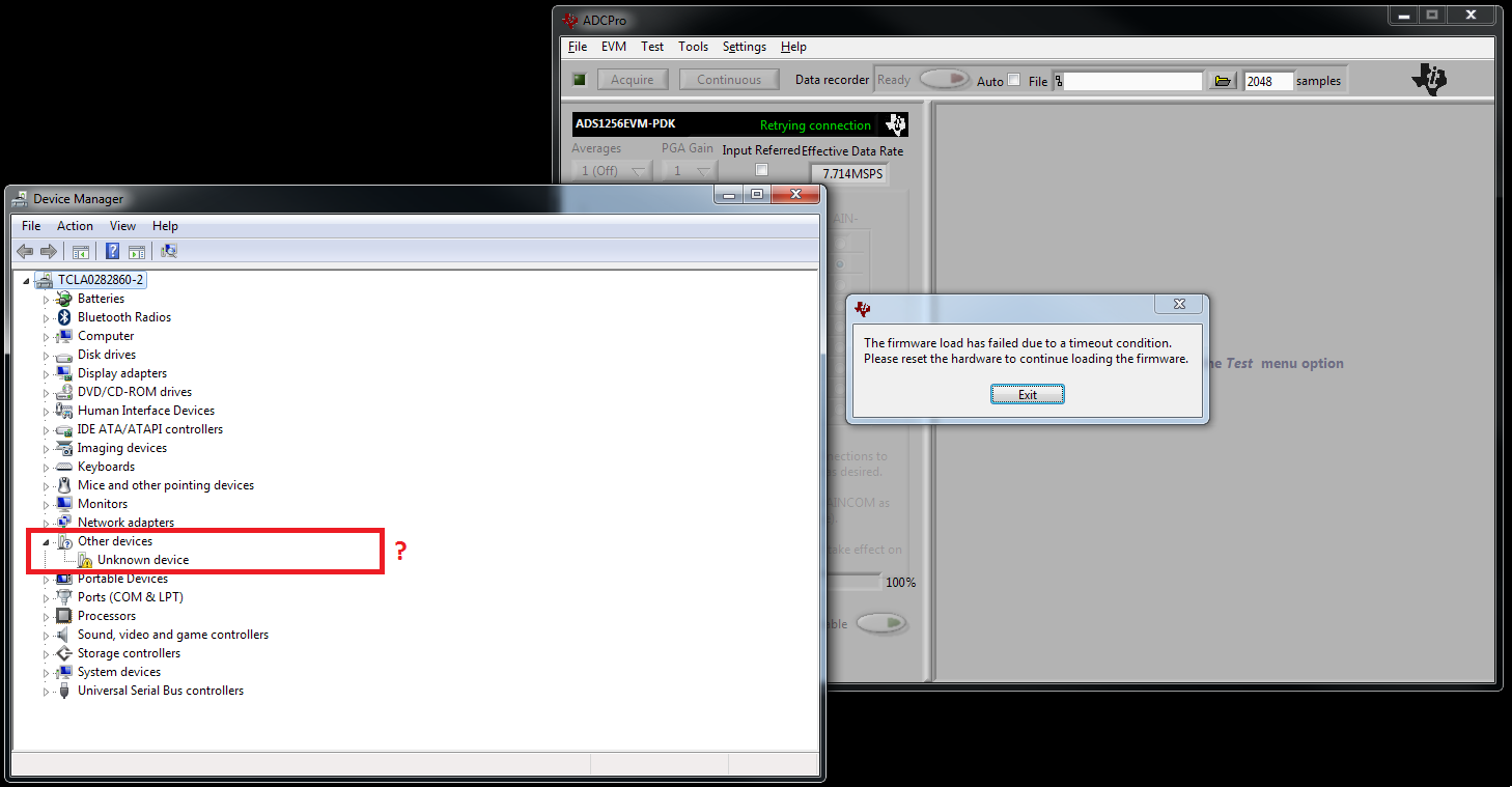

I am attempting to use the ADS1256EVM/MMB0 with very little luck.  I have installed the drivers and got the MMB0 (NI-VISA) device to show up in device manager.  I then run ADCPro, try to load the ADS1256EVM plugin and get the DSP not ready message.  I have tried 3 different PCs, connecting +/-VA to +/-5VDC and +/-10VDC with no change.  We have 2 other MMB0 boards here and I tried those with no luck.  The USBStyx driver does not load and there is no unknown device that appears while the plugin tries to load.  Any help would be appreciated.

  • Hi Travis,
    What is the error message you're seeing...Are you getting "The firmware load has failed due to a timeout condition" message?
    If there was an error reading the EEPROM then you would likely get an error message saying that there was a problem reading it...
    Does the "MMB0 (NI-VISA)" device disappear in Device Manager after trying to connect to the EVM in ADCPro?
    If so, then the firmware would appear to be loading correctly on the MMB0.

  • Hi Chris,
    Response to question 1 above...this is the sequence I see:
    1. Locating binary file
    2. Reading binary file
    3. USB connection established
    4. o firmware found...downloading
    5. Download successful
    6. DSP not ready...Retrying
    7. Retrying connection and a pop up window that says The firmware load has failed due to a time out condition. Please reset the hardware to continue loading the firmware.
    8. EVM/HW Incompatible
    Response to question 2 above...yes the MMB0 (NI-VISA) disappears
    Response to question 3 above...I have the ADS1256EVM/MMB0 connected prior to starting ADCpro. All jumpers/switches are in their default locations.
    Thank you.
    Travis Opsahl
  • Hi Travis,
    When you get the error message "The firmware load has failed...", what do you see in Device Manager?
    ...Do you have an "Unknown device" entry appear in Device Manager, or do you see a "libusb-win32" device appear?
    If you see "Unknown device", then likely it the problem is driver related. If the later appears, then I think the MMB0 is failing to communicate with the ADS1256EVM daughter card, which could be an indication of a hardware problem.
    Chris
  • Hi Chris,
    In device manager I do not see an unknown device appear or a libusb-win32 device appear. When I hit the reset button the MMB0 (NI-VISA) will come back, disappear when I try to load the plugin, and don't see anything until I hit reset and it shows up again as MMB0 (NI-VISA). Is the ADS1256 most likely dead then?

  • Hi Travis,
    That's certainly possible, but we test all of our EVMs so it would be rare that you would have received a bad EVM...
    I was able to recreate this issue on my PC by interrupting the communication between the MMB0 and the ADS1256EVM daughter card. Therefore, I would like to check a few more things to see if something else might be preventing proper communication. If after that we still can't communicate with the ADS1256EVM, then I could try ordering you another ADS1256EVM to see if the problem is really that EVM.
    Do you have all of the connections and LED power indicators working, similar to the image shown below?
    Would you be able to probe the ADCAVDD and ADCDVDD (J4) jumper voltages to double check that the ADS1256 is powered (to 5V AVDD, 3.3V DVDD)? Also double check that the AGND and DGND jumpers are connected.
    Finally, try switching S4 to the right (EXT CLOCK) in case the crystal is not oscillating,
    Let me know if any of those things resolves the issue or if you find a problem. If you still have issues, would you be able to send me your contact and shipping information (send it to pa_deltasigma_apps@ti.com) so that I can order another ADS1256EVM for you?
