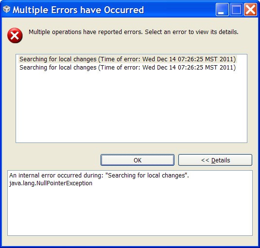

I restarted my CCS because it always locks up after cycling power on my device. now I get an error when I launch CCS and my project no longer builds. I wish I knew how to keep CCS running and avoid distracting delays every time I have to kill the process.
here is the error dialog when I launch CCS.  I get this error all the time on another machine.  on that one I have to remove and readd all of the projects in the workspace.

  • Kurt,
    Given that you had failing debug sessions, my best guess would be a corruption in one of the temporary/cache files created by v4 - you can always revisit the Debugger section of the troubleshooting page
    Although a perfectly reproducible testcase is hard to get in such random cases, sometimes when a core is hang by any external reason, CCS can be unfrozen by unplugging the emulator from the USB port. This causes CCS to promptly recognize the communications failure with the emulator itself.
    To further analyze this issue the debug server log would be needed (the methods to obtain it are shown in the page above).
    Regarding the error message, some previous reports (here and here) mention that this pesky error message is thrown by corrupt projects in your workspace, unfortunately we were never able to obtain a concrete reproducible testcase that would help us analyze this further.
    I imagine you probably tried the clean up procedures listed in the section General IDE section of the troubleshooting page above, is that so?
    Rafael
  • basically cleaning the .metadata and the workspace usually recovers from this problem.  my issue is that it seems to be a regular problem on multiple computers.  was hoping there was some kind of solid solution.

    In conversations with some colleagues they mentioned an intermittent bug in CCSv4.2.4 (SDSCM00041821, status in the link SDOWP below) that manifests itself as severe delays during the connection process.
    The workaround to this bug is to rename a component called <cTools.dll> that is located in <ccs_install_dir>\ccsv4\emulation\analysis\bin to something else and restart CCS.
    This particular issue was fixed for CCSv5.1, but it surely would be worth trying this workaround in your case.
