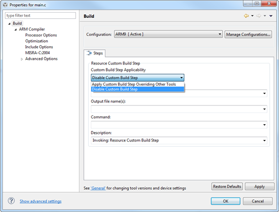

    If you want to apply a custom build step to each file, right click on it and select Properties. You should see a screen similar to what is shown below:
    I am unsure if there is a global "per file" build step.

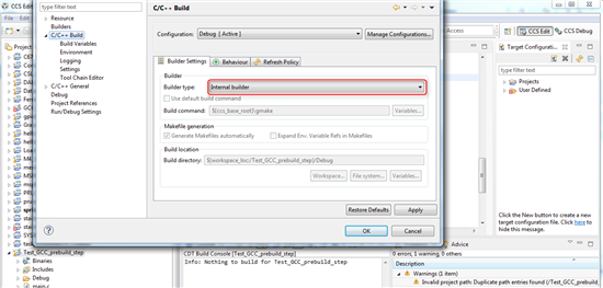

    Sorry, now I got what was the original intent. I did some experimentation and found out this behavior is expected for the CDT (check the Eclipse documentation) but it only works when using Eclipse's Internal builder (this is shown in this bugzilla).
    This option is only available for standard CDT projects but not for CCS projects (perhaps incompatibilities prompted suppressing this option).
    I will reply back if I get some additional information but unfortunately at this time this behavior is not possible to be enabled.
