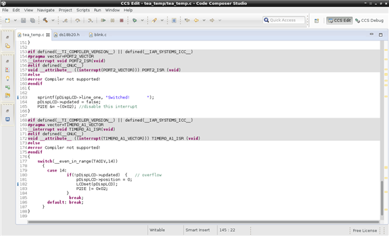

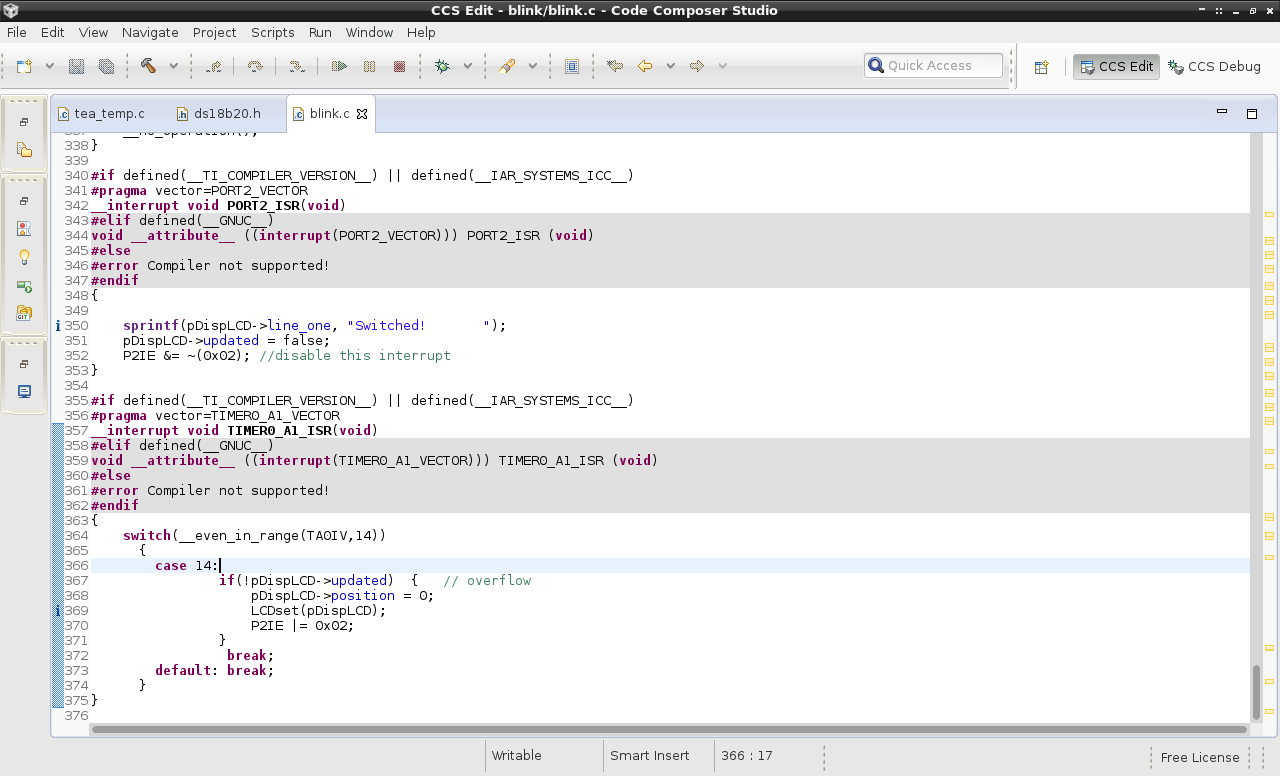

  • Sorry to bump a necro thread, but it seems better than starting a new one.
    It seems that it's been over two years since this issue was reported, and yet it's still occurring! The strange part is certain projects highlight correctly, and others don't. In one case, two different files with the exact same source code highlighted differently. The reason I'm concerned is that it's not clear whether or not the preprocessor is actually handling it correctly -- will my interrupts be omitted?
    Example:
    The highlighting in the CCS editor is done by CCS trying to track which macros are defined in the code, which CCS sometimes gets wrong. If you are concerned about interrupts being omitted by the compiler, try putting #warning into the #if conditional parts to see which one the compiler preprocessor is seeing as defined.
    To see which predefined compiler macros CCS is using for a project look under the CCS project properties and show the advanced settings under C/C++ General -> Paths and Symbols -> Symbols. For a project which has correctly detected the TI compiler predefined macros you should see __TI_COMPILER_VERSION__ in the list of symbols (among others):
    Are there any differences between the symbols shown in the project where the highlighting works and the one where the highlighting doesn't work?
    Also, are you using Linux or Windows?
    Under Linux I have seen that sometimes the TI compiler predefined symbols are missing for some projects, but didn't track down what caused the problem.
